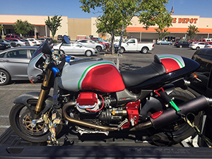

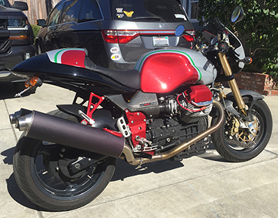

if anyone knows how to post larger images let me know. heres another one my 02 scura in coppa italia clothing.....
I haven't decided if I like the paint this way. There may be a paint job in this bikes future to bring it back to the satin black/gray original look. I think it's hard to beat that look.
#389 Grover Beach, California
Thanks! I've been having V11 envy ever since getting rid of my 03 lemans years ago....finally back in it. This actually is a scura but the owner had it painted to look like a coppa italia color scheme. Paint was done very professionally though.
