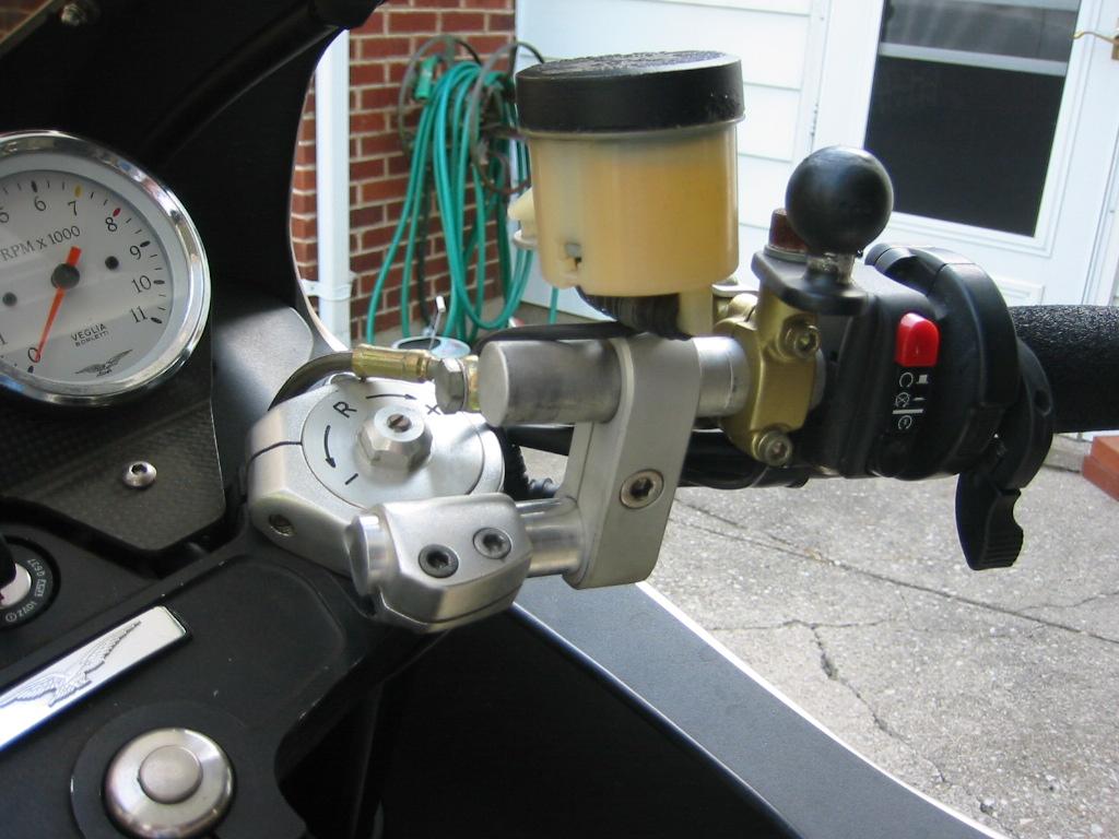

  1. I'm confident adding a second pair of offsets would be a waste. I contacted the manufacturer with my concerns about it torqueing. I told him I was planning on drilling the lower half for a roll pin. He said that coating the joint with an epoxy will make it as if it were one piece. It would break before it twists.

  11. For the record the only place I needed the shim was in the top half of the offset where there is literally no torque. The bottom half of the offset is split clear through so it clamps very tightly around the stub. You can get quite a bit of clamping force with an M8 screw. I'm going to key the offset to the stub for piece of mind. The stub is keyed into the fork clamp with one of the clamp screws.

  17. The torque was also a big concern of mine. I plan on drilling for a roll pin in the bottom of the offset after I've made the final position determination. The dealer suggested using epoxy and I'm thinking about going that way.
  18. Here is how I managed to install a set of risers on my '02 LeMans. I got the idea of switching around the clamps from a fellow in Italy. I picked up the offsets from www.cliponrisers.com for $40 apiece plus $10 shipping and handling. I had Lee Bruns make the bar stubs. Nice work by the way. The offsets are bored for 7/8 inch bars. The existing bars are metric so I had to fill the space with a piece of .007 plastic shim stock. I had to relocate the front brake hose through the lower fairing cover next to the right fork leg to make it long enough. I rerouted the throttle cable behind the triple tree. The jury is still out on if the hoses need to be extended. This moves the bars back about two inches and up about one inch. (The 11,000 miles is on my second odometer.)
