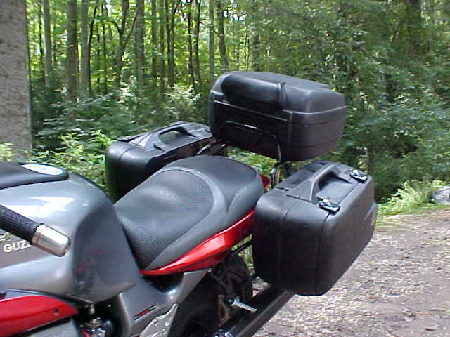

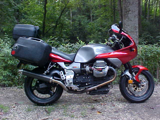

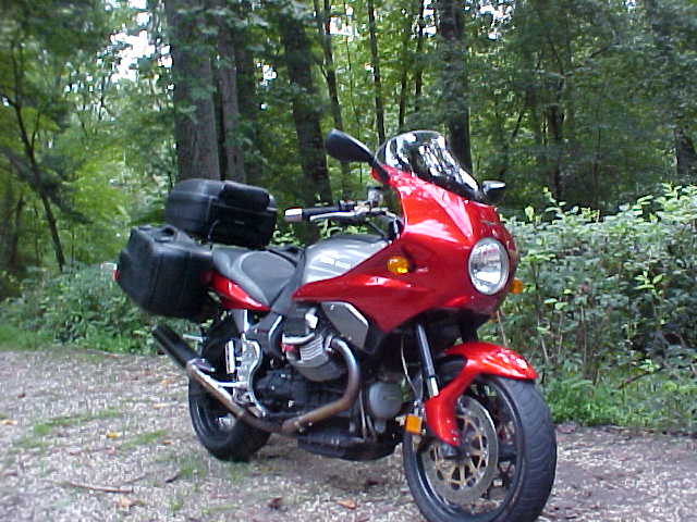

Wow such great bikes in this crowd! Congradulations on ANY finish at Daytona.What an accomplishment. Here's my Sport Tourer.She's set up for the long haul. OOPS I goofed on those pictures.Let me try again.
