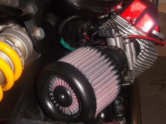

  3. bit slow seeing the thread... hey look thos for and against have good reasons for there choice. Ok, its not a good idea to remove the air box its design is the best thing for the engine.. however if you spend the time there is a chance you can get the bike running beter than it ever has. With the help from Marty my bike runs incredibly beter than it did out of the create, and I rode it for 65000k befor doing the mods, this includes remapping and re positing the air temp censor a must to keep... now a reason it all worked so well is due to like kiwi roy did the factory velocity stacks. see my photos in the link Marty posted on pg1 good luck and expect to be troubled by it till ya get it right

  5. ohh, bit of a thread dredge guys... and think thers a few posts missing, bikes running best it ever has with pods and large pipe... issue was running to lean has since day one, sorted by remapping.

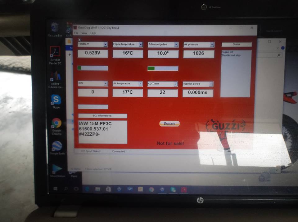

    anything done to the airbox will proberly make it worse yours dosnt really sound much differant to any other V11, It just sounds like the typical lean area that the emision nazis inflict on maufactures, try raising the CO trim to +50 then drop it back till ya happy... other wise yes remap, remember with your guzzidiag you can save the existing map

    yip easy as on GuzzDiag... I run +22 but am allready remaped richer, so stock ECU +50 no worries. Now if you want to re map yam350 look into Meinolf's tricks I aint ever looking back. ps yam350 used to race a 350LC awesome bikes but worth so much these days.

    NZ video

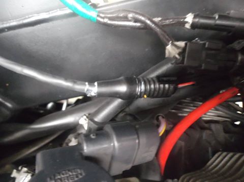

  14. well I did kinda raided the pub over the hill... was the only spine there tho any hooo... I didnt think there was much of a diference with the air temp disconected, but with the new extension shit, started beter, and smoother bit more peaky, could be in my head but im sure its happier with it conected... cheers Marty. I owe ya more
  15. Hey thanks heaps Marty, BTW the plug connected very easy and on 2nd try... again I owe ya, hopefully tomorrow Ill be able to give it a road test. docc... WTF are you dribbling about LOL do you mean the Akaroa GP (best done early or during the week) ahhh what did we do?
  16. Once again thanks to V11 owner Marty he has assembled this extension for the air censor that used to plug into the airbox. Photos explain all really, ECU is now happy its reading a censor again. Marty did design it to bolt down to the old air box mount as pictured but I was concerned its right in line of the rear wheel splatter, so went up behind the battery, anywere under the tank would trape heat Ideally if it was 100mm longer behind the side of the tail piece or in the case of a LeMans forward of the fairing.

    DD, Would you like me to make you a sensor that can slip into one of the pods. It may run OK now, but as air temps change, the ECU needs to know about it, as the sensor affects both fuel and ignition advance. It will cost you about $2. Then maybe I can get my laptop back. As for comparing fuel trim on your bike with a standard bike, remember that your bike has Meinolf's #42 .BIN file loaded into the ECU, which is lots richer than the Ti ECU. And your bike is free flowing at both ends, so needs lots more fuel than mine or BigBlock's. Air Intake Sensor.jpg well... do you want ya laptop back or not LOL ;-) Yeah hey if ya want that be great thanks... I was just going to chop the wires and extend it under the seat... yoiur idea sounds a bit beter than that and it be worth more than 2 bucks, already owe ya beer or whisky or what is it you drink?

    Im at +20 and no air temp at the mo... best its ever ran, tho with air temp censer in hanging loose as I have pods, the censer was 43* so the bike would lean out, gave me a massive power spike but I was worried it was to lean still. Ill extend the air temp and hide it under the seat when I get a chance... and Marty SHIT sorry forgot I still have ya laptop, im away this weekend at a rally down south please rark me up to return it.
