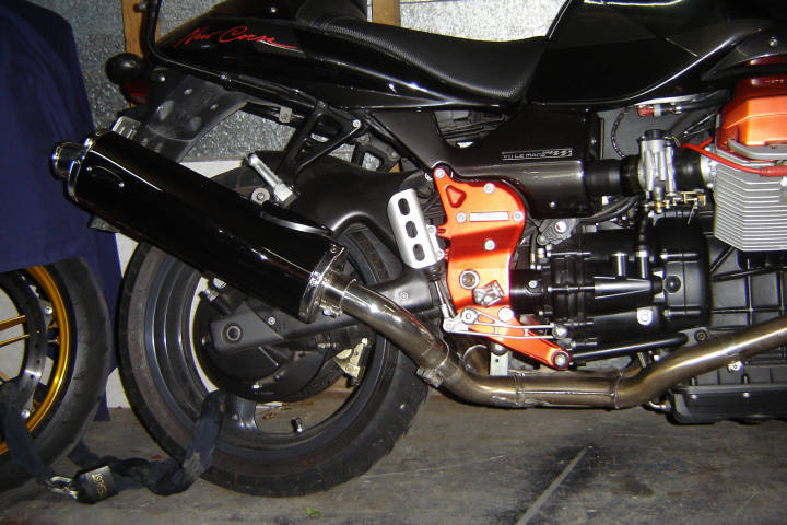

  2. Na NZ made neptune cans, black stainless, very nice but easly marked. Other mods, the screen is a Oz import as a seagull flew through the origional so it is a darker tint and has a lip on the top edge to deflect a little higher and smoked indercator lenses with orange bulbs... thats bout it.

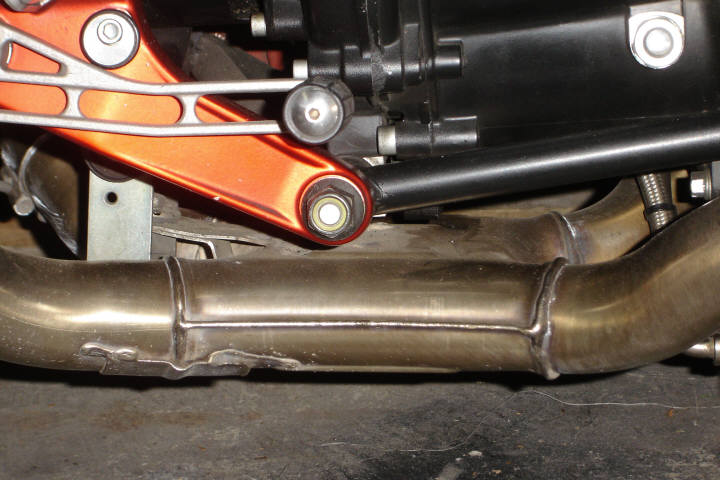

  14. Hey fill me in here, the cross over you speak of, go back a few years and a replacment on the 1100i sport made a differance and most sports had the colostamy bag swaped for a x over. But the cross over on the V11 (04) is nothing like the old sports, its more like a aftermarket x over, in my 04 there is a gas sencer in the cross over, a replacment one like you say does it have a sencer in it? would I notice a differance with my bike?
  15. Havent seen em in yonks, were abouts are you looking at getting them from? I use Neptune (Wellington) but unfortunatly they have turned turtle, a farking nice muffler they made to. So another option is Zorts, local to Chch they have a tunable baffel and removable spud... other wise if looking at an import then ya cant beat Mistral or Termie.
