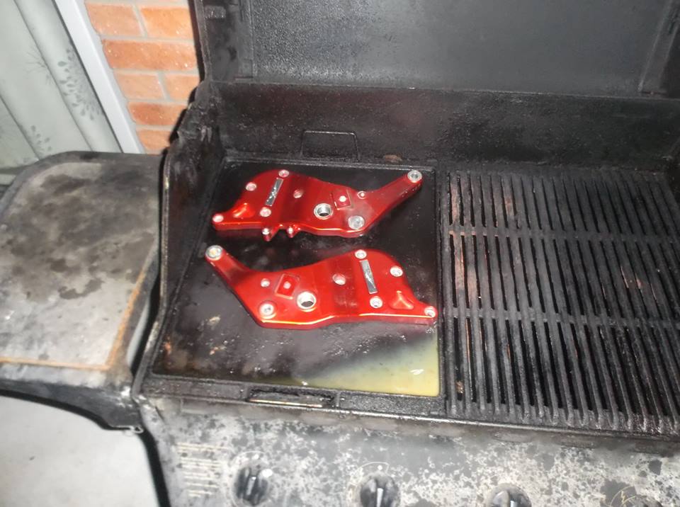

a ferrious goose rear, well the bike is down here, but seems the red chops were used on a few others... ohhhh rare they have faded well, its the rocker covers that are pink the right bearly that so if I have to paint the covers ill have to match the chops. Rather an importent part of the bike these chiops aye, hold the hole bloody thing togeather, lower sub rear sub the arm and the spine.
