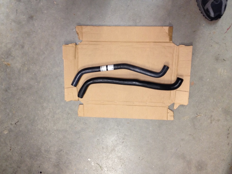

My failed hose was not original. I replaced the original when it was about 10 years old because I had the bike apart so I thought I might as well replace that hose before it failed. As you can see the replacement expanded and got very soft from the crankcase fumes. I assume whoever made it used the wrong material for the job.

I had a hose fail a few years back and when I removed it I was surprised at how soft it had become and how much it had enlarged. I went through my receipts but I'm not sure which vendor I bought it from. It was less than 5 years old. Here's the new hose next to the failed one:

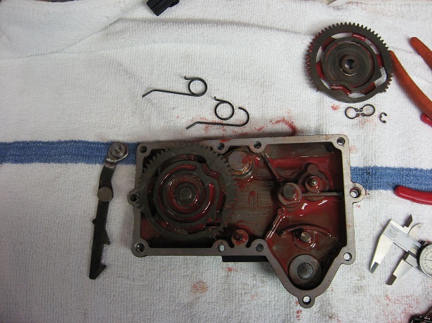

Swooshdave was looking for more broken spring pictures. Here's mine. I've had three springs break. I believe two of the factory supplied springs broke as shown in the attached picture. I also had a Cannon Racecraft (?) spring, which was made from a heavier wire, break at the tightest bend. I don't have that picture any more. I'd be happy to buy an alternative to the factory part if you guys come up with something. I can help with design and fabrication of any parts other than a spring if needed.
