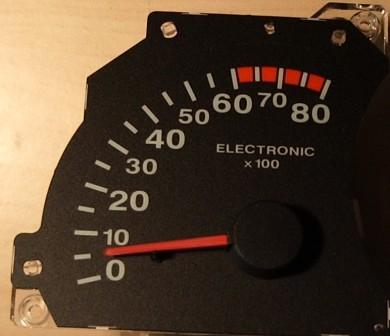

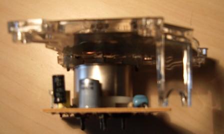

  3. pasotibbs
    tach
    The chip reads ELEX 14308D 6619A 3896 so is different (that would have been too easy !!) circuit board is marked MA 5504 10170000 the motor has no markings at all and is capable of 270deg+ motion so is probably a common part- as far as I know they do not fail in car application so failure may be due to the greater range of motion we have and/or vibration ? I'll measure the spacing and resistance when I get chance to confirm. Dave

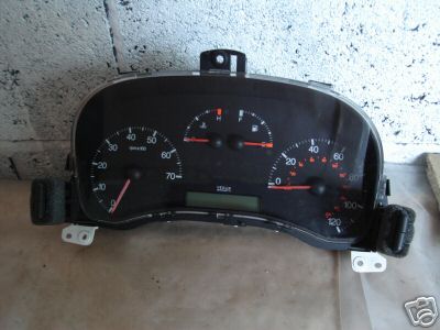

  5. pasotibbs
    tach
    The speedo on my Fiat stopped working today so while I was fixing it I took a photo of the tacho mechanism(I'd pulled the cable out of the head unit while fixing the wiper linkage... ), is it anything like a guzzi tach ? sorry the pics aren't very clear.

  17. pasotibbs
    tach
    I've often thought about checking the Veglia Tach's on Italian cars as they will probably share a lot of components with ours (I discovered this a few years ago with a Ducati Dash ! ). The Fiat FIRE engines (Fiat Cinquecento/Seicentoi/Punto)use a wasted spark ign (WM16 or similar?)so the tach may think its on a 2 cylinder anyway, but on the car tach's I've seen the values wouldn't line up with our faceplate so I don't think a direct swap of the complete internals is possible ?
