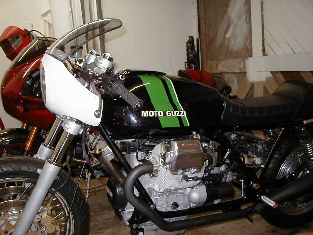

  8. This is getting weird , If I had never saw the Le Jackal project in the works, I would of never thought of buying a Jackal . Well, I am happy I did, now I just need time to finish the project. The small circle of Guzzi ownership! Mike
  9. Wait a minute, You were the owner of the Le Jackal? I too have a Jackal project, 1100S in the works. I believe I talked to you about it. Humm, small world. Mike

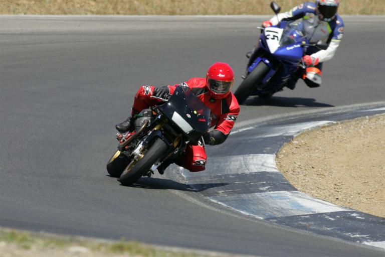

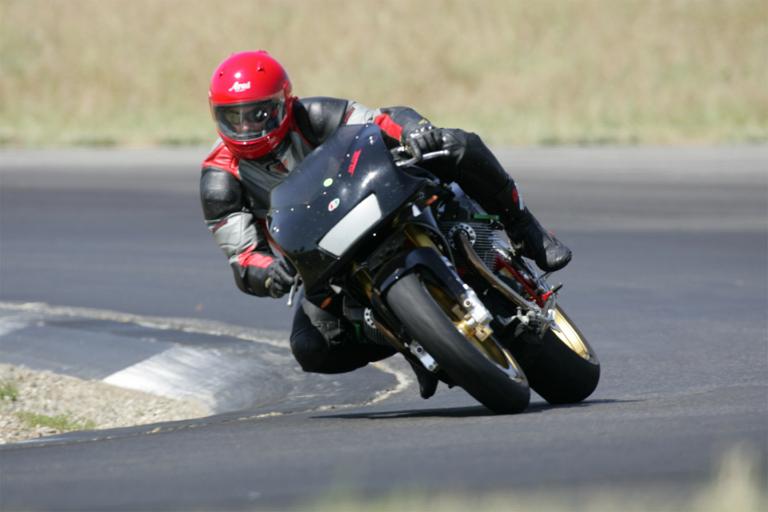

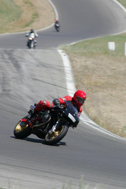

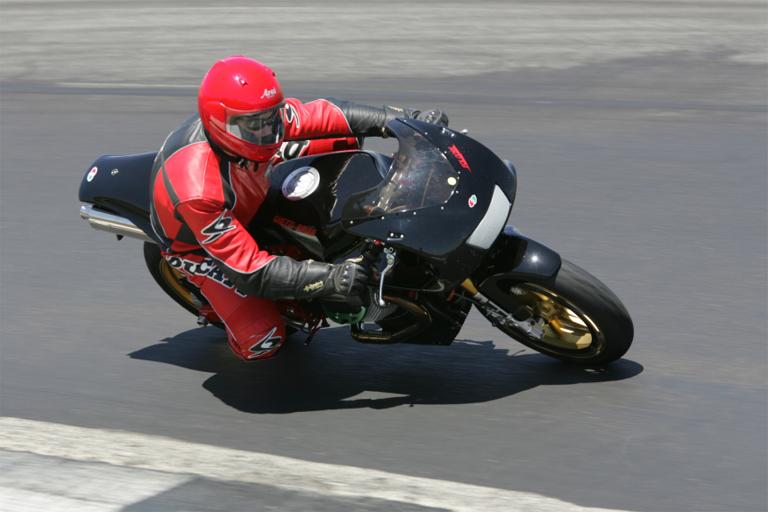

  14. Well, I just spent the last two days at Thunder Hill, a race track in Northern California . Two years ago, I did my first novice track day school on my Aprilia Falco. This bike was fast and handled well. I wondered how a less techno (modern) bike would preform. Some friends and I had signed up for the Keigwins ( http://www.keigwin.com/ ) two day novice track day months ago and now it was time to go out and do it. I had reservation about taking the beautiful Ghezzi-Brian, but I was very curious on how it would do on the track. It also would be a great place to learn any short comings of the new bike. Weeks earlier, I was still working on the bike to make it more driveable. A valve adjustment, throttle sync. , remaping, remaping and more remaping to rid the bike of the cough at lower rpm's. (We are talking a big hic-up here) Having a big cough when the throttle is rolled off and back on while leaned over could cause major issues. I also had false neutral problems, mainly on down shifting. This could be a problem going into turns at speed. I thought it was going to be a internal transmission issue, but after looking at the shifter/linkage, I found that the linkage would hit the frame if the pivoted was in the right spot. Just an adjustment to raise the shifer up 10mm. fixed the problem. I was going to bring my 03 Rosso Corsa as a back up bike, but the Ghezzi-Brian was running excellent. I still wondered about doing two days on the track with very low clip-ons, and I also was worried about the harsh vibration at 6500 rpm. The first day at the track the bikes were inspected for the normal, brakes, leaks, loose bolts etc. Yes, the Ghezzi got the most attention of the 60 plus bikes. There were many remarks such as, "shouldn't that bike be in your living room?" and " Don't make us cry" (meaning please don't drop it). We had our riders meeting and went over the rules of passing (just on the outside), the meaning of the flags and a few other things. I was in the B group (the slower of the two groups), I mainly wanted to start off slow so I could learn the bike as I picked up speed. The site in laps were at 60-65 mph, this was quite abit faster then what I remembered at this track two years ealier (same school). It still was not a problem for me, but already some students could not keep up. Anyway, the Ghezzi performed flawlessly, (after a remap for the ping at 3500 to 4k coming out of some slow turns). The Ghezzi is very stable at any speed, braking is second to none, bike turn in is effortlessly and the sound of the exhaust turned many heads. I visited the free suspension setup booth by GP Suspension Inc. I had the compression of the front forks cranked all the way in to rid the forks of the fast fork dive when the brakes were applied. A few sag measurement and hard jounces on the front forks revealed the forks would not move through their full travel. Loosening up the front fork preload and compression damping made the forks way too loose and now the suspension specialist now knew what I had been fighting. He suggested a revalve of the compression circuit and checking the fork oil level. The forks will have to be removed for the repair. He added more spring preload and less compression damping so I could finish the second day at the track. The bike was more compliant now, but I will still take the forks off and have the valving redone as suggested. I was wearing the red riding suit on the first day but the right shoulder was too tight and did not allow me to point or lead with my right shoulder while hanging off the bike. The second day felt much better and I could move around more freely. I have to recommend Keigwins at the Track to anyone wanting to do some trackdays, great detailed instructions, very patient instructors and alot of track time! Mike
