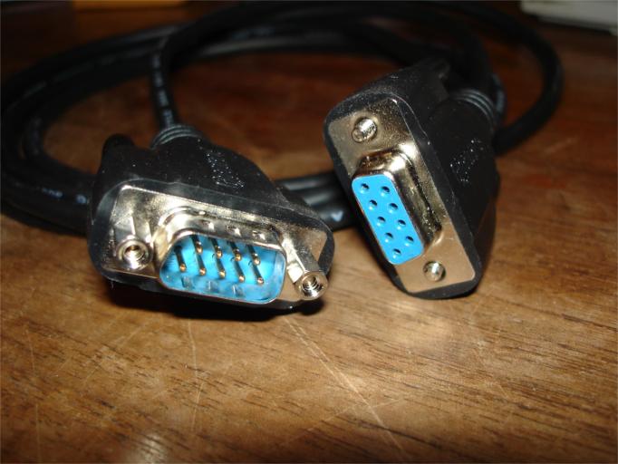

You will need a DB9, 9 pin cable, female end on one side and male on the other. I would download the manual from the Powercommander site so you will know what you need. The non-usb models in the U.S. do not have the 9 volt battery option, I have only seen this on the usb models. I have used about 8 of these the last few years on the many bikes I have owned so I have been around the block with them. Oh, and the Powercommander IS NOT Apple friendly! Mike
