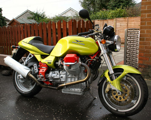

  4. My V11 Sport

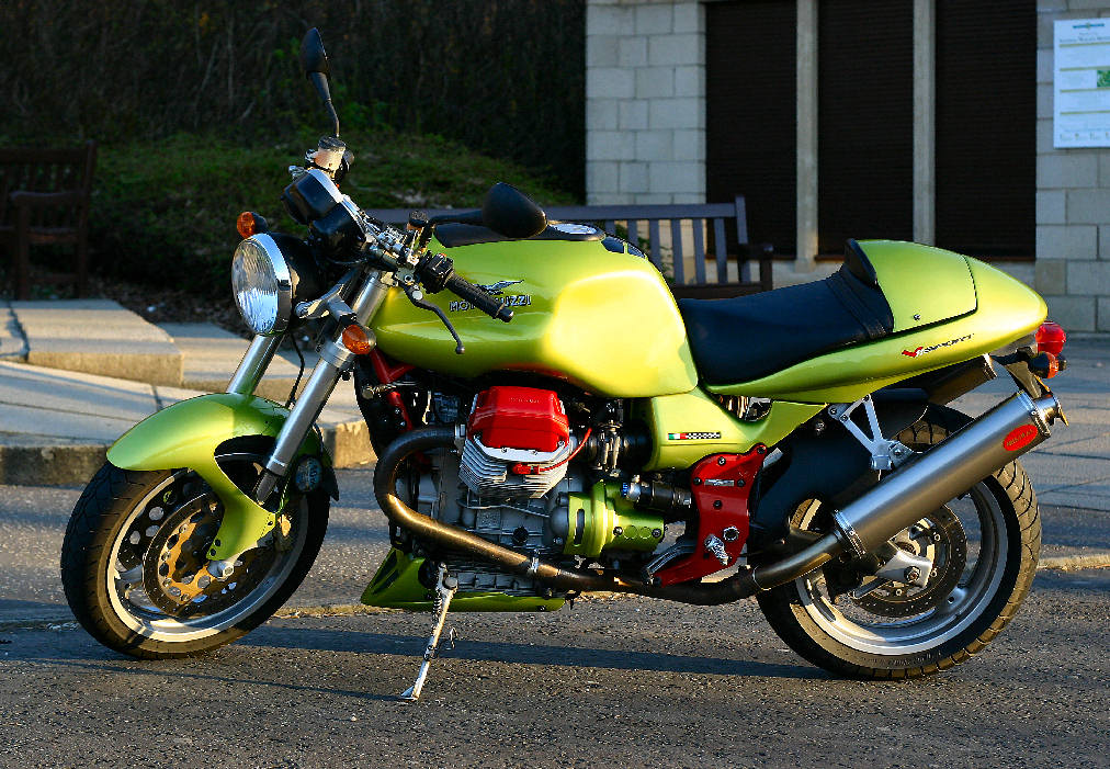

  9. Hi Guys, just thuoght I would give a wee update on the fuel pump. Went to the BMW parts shop in Glasgow http://www.gsfcarparts.com/ and picked up an erstklassig fuel pump. Part number B18115, equivalent to Bosch 0580464070. When I seen the equivalent number at the shop I told the assistant that this is not the Bosch part number I asked them to cross-reference. After a bit of head scratching he told me that it eventually does cross-reverence to the Bosch 0580464048. I have no idea what the differences may be. But it works the beast is back on the road and to celebrate I even gave it a wash & polish. Boy it sounds *lovely* with the Mistral X-over and the Ti Oval cans The pump came to £85 inc VAT. Updated avatar piccy as old one was alittle out of date. Next mod may be a small flyscreen.
