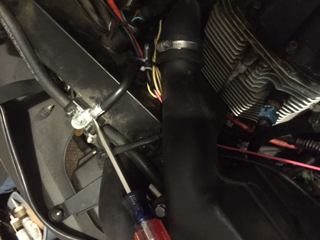

  11. I put a ground from the voltage regulator to the frame here (where the screwdriver is pointing). I put a 30 amp fuse in the red line from the battery (you say 40?). I think I'm ready to put the tank back on but I have to go to work now. Maybe tomorrow. When I try to start it up, I'll roll it in to the driveway, out of the garage. I don't want to burn the house down.

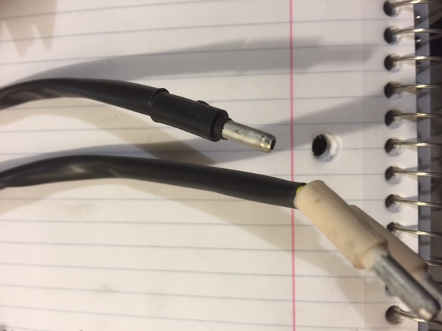

  14. This is the end of the double red from th new VR
