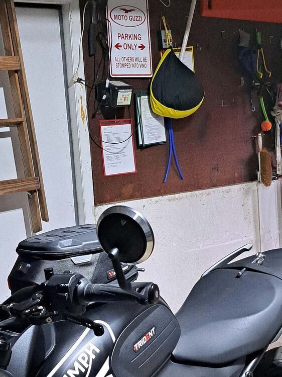

This just happened, so I may need to update garage signage. The V11 is still here/for sale and even so, I occasionally experience seller's regret -

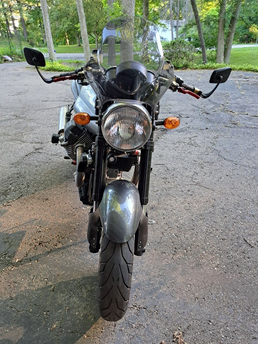

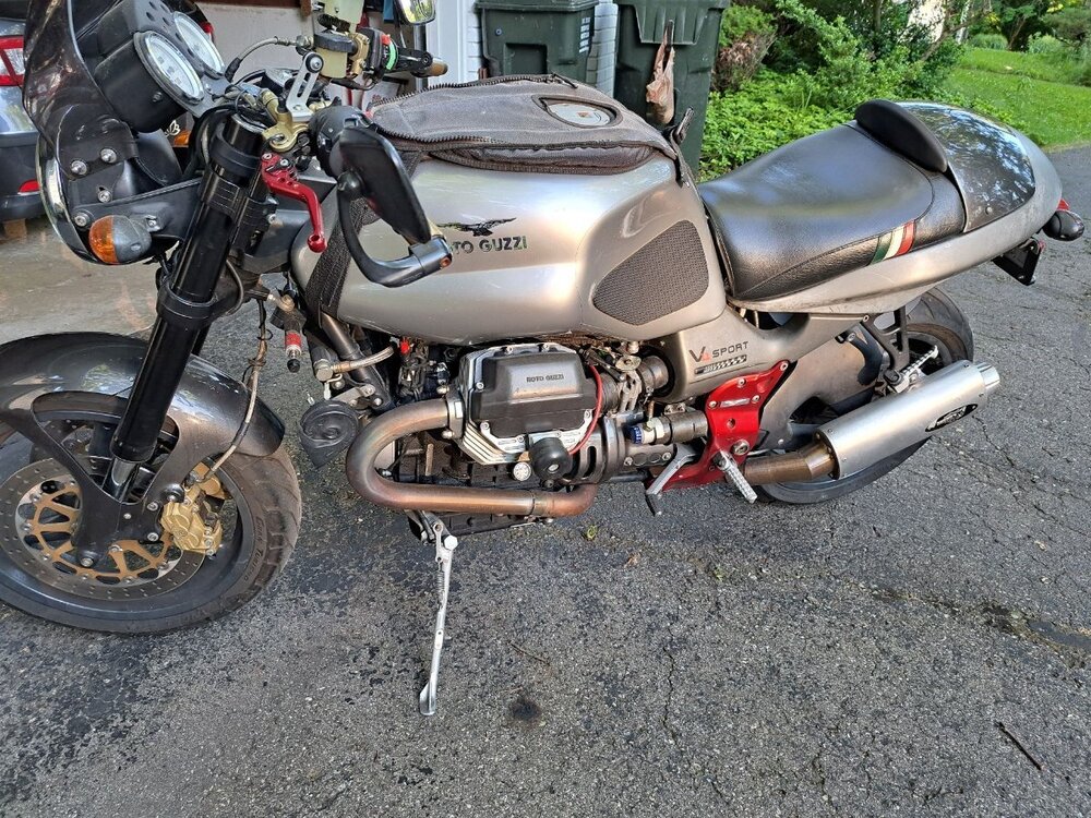

After 21 years with my V11 Sport it's time to move on. I lack the time, space, and dedication to maintain it and I'm wanting something lighter for my occasional backroad rides. The good: one adult owner, most of the usual V11 tweaks/fixes/upgrades and regular maintenance have been performed, strong low-mileage engine (about 21,500 mi) runs well, nearly roadworthy, and it's got the looks and feel of that raunchy girl from high school. Sale will include a good number of new and used spares and consumables. The bad: cosmetically rough, non-functional speedo/odometer, and it's got a clutch (or clutch actuation?) issue that I don't understand. It's initially ridable when cold, but begins misbehaving in an erratic/intermittent way as it warms up. The clutch slave was recently dealer serviced to no avail, so I'm opting out. I think that there's a good opportunity here for someone who wants a potentially easy project or near complete parts bike. $1200 OBO; local pickup only. PM if interested.

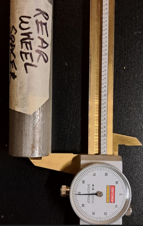

I had a few made up when a rear bearing failed after only 3 years. I do still have a spare made from this: https://www.onlinemetals.com/en/buy/carbon-steel/1-od-x-0-095-wall-x-0-81-id-carbon-steel-round-tube-a513-type-5-dom/pid/7564 I don't recall flanges, but can say that I installed one in 2006 and haven't had any bearing failures since.
I've likely got a spare (I had several made years ago) for the cost of shipping. Can check if you like.

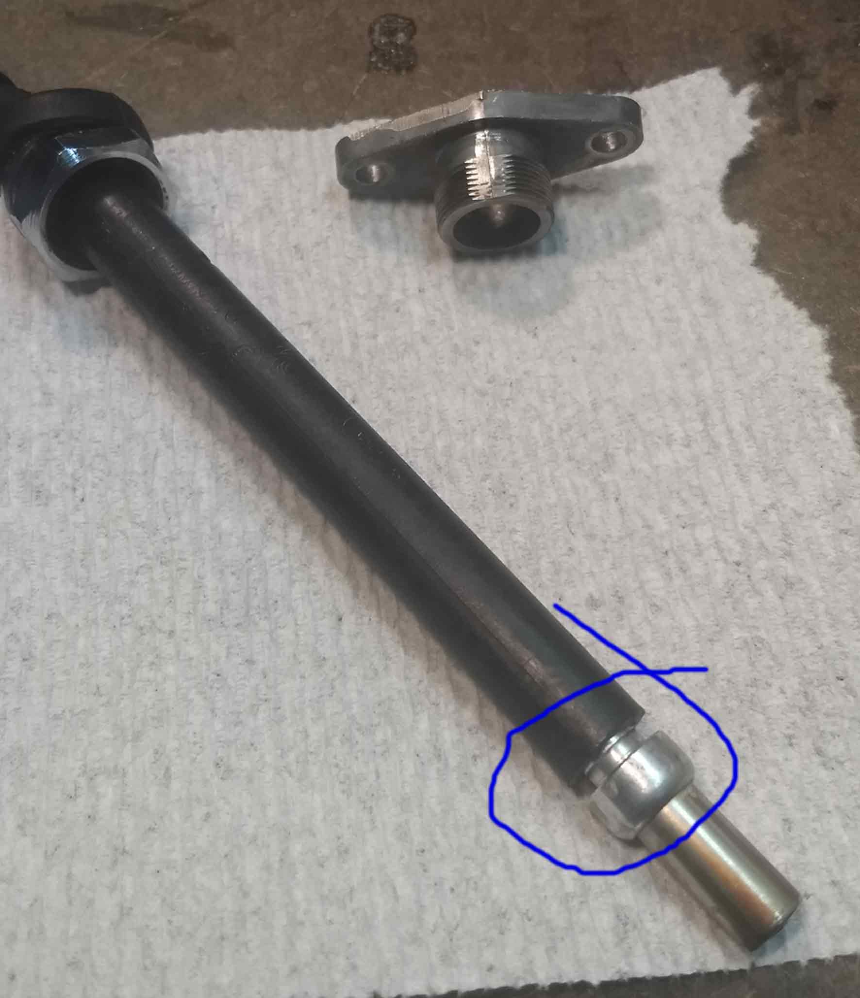

This looks to be sorted, so thought I'd post an update. My issue was a slow fuel seep from the fuel level sensor, which had never been off the tank since I purchased the bike new. Gas was collecting under the rubber boot, so after seeing the photo Chuck posted, I suspected it was seeping through the potting or one of the mounting flange-washer-sensor mating surfaces. I guessed that the leak would be less localized if the tank-flange interface (ie - the o-ring) was the problem instead. I pulled the sensor and found the aluminum washer at the base was pretty cruddy. Likewise there was material caked onto the rubber of the sensor housing itself. Guessing this was mostly calcium phosphate from EtOH-water issues. I also found that the sensor had come unglued from its rubber housing, perhaps because the rubber had swollen over the years (see photo). The mounting flange and o-ring had a bit of caking as well. I cleaned everything up, re-installed with Permatex non-hardening liquid gasket, and leak tested O/N with a 1/2 tank of gas. Next day…TA-DA! No leaks…what a hero! I filled the tank on my victory ride, and sure enough the wife complained of gas smell in the garage-adjacent TV room that same night. I'd had enough. I bought a new sensor and a tube of the reputedly magic Hylomar, drained and dried the tank, and brought it inside where I could work on it patiently. All mating surfaces got skim coats of Hylomar, which was allowed to dry thoroughly at RT before assembly. It's been about a week with no leaks. I don't know precisely why the old one was leaking, but decided I'm ready to move on and live with a little more mystery in my life.
Much obliged gentlemen. Regarding removing / reinstalling the tank multiple times, hanging it partly full to ensure no leaks, installing a new o-ring and blue-goo, eyeing a new sensor on Ebay....guilty. I've never had the sensor out of its mounting fixture, so it's time to check that washer. Seems like a likely culprit given the pooling into the boot. Any harm in applying a thin coat of non-hardening fuel-resistant liquid gasket to the washer (assuming it's intact) ? The upside is that this leak pushed me to finally get some EtOH-free gas and groom the rubber pucks. Just anuther day with the V11.
Super helpful to have this documented! My V11 developed a fuel leak while it was in storage this past winter, and I've localized it to a slow seep at the fuel level sensor. After leaving it overnight, I peeled back the rubber boot, I found it filled with fuel. So, I'm wondering if the leak is somehow through the body of the sensor, rather than past the screws or around the o-ring. I can't recall any mentions of this, but maybe someone else has or has ideas about whether it's likely or repairable. I've got blue goo, but the weeping continues....

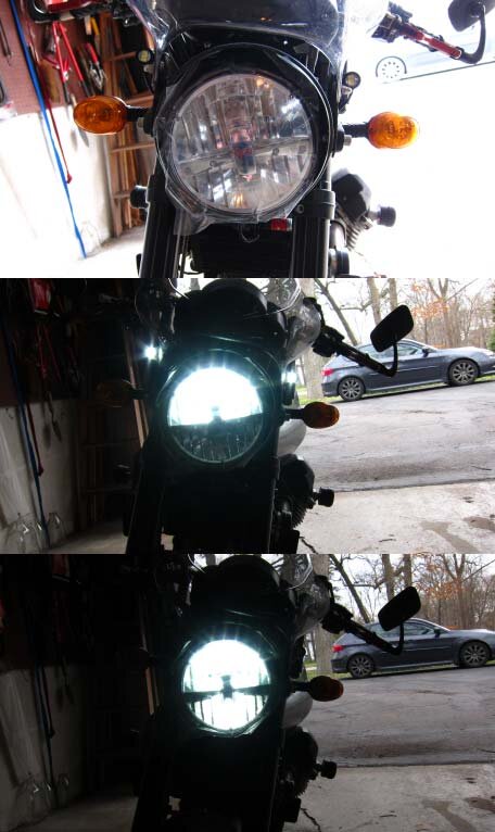

I was recently inspired to try and improve my headlight. Didn't succeed, but thought my experience might be useful to share. The deflector inside my original shell came loose some years back, and though I've been able to wire it back in the sort of vicinity of its proper location, the output and pattern is silly poor. I tried a 7" Grote sealed beam from Summit Racing (https://www.summitracing.com/parts/gte-90941-5), hoping it could be adapted without too much fuss. I found that some fuss would been needed. I may eventually go that route, if I can convince an engineer buddy to design and 3D print an adapter. In the meanwhile, I'll be sticking to daylight riding. I would be happy to hear of a source for a fully intact OEM unit.
