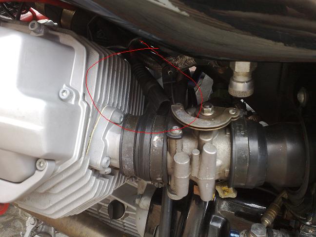

Hi, Ryan thanks for the response. The second pick I've circled the bottom of the airbox and a bit that appears to be part of the fuel system. The First pic I've circled a lead that appears to be a plug for something... -
Alright. Had a look through the forum about Guzzi fuel consumption and found that they are supposed to consume about 35 mpg or somout depending how you ride it. I filled mine upto the max and rode it for 83 motorway miles until the red fuel light came on! Is this normal??? My spark plugs are 'sooty' and when I used the spark plug endoscope type thing that allows you to look into the spark plug chamber bit it was burning with a orange - red flame. Also, when I start her up you can smell petrol, or even when she is just running you smell the whiff of it. All the evidence points to the mixture being seriously rich. The choke doesnt appear to be stuck on as when I turn it on it speeds the tick over up, but it has had raised bars put on it. What causes this? Also, I noticed a bit on the engine that a pipe should be connected to but dont know what or where it should go as its never been on it since I bought it and was thinking that this could be effecting the mixture. How do I rectify the situation? Does it need re-mapped. I know that the last owner re-wired the whole lot including relays and ECU... I've done a forum search but turned up nothing... Also, there seems to be a wire hanging thats not connected to anything, was wondering if this could be effecting petrol consumption being not plugged into anything. Any suggestions are welcomed as I would like to know if A: this is normal and if it isnt how I can go about 'fixing' it. Cheers!!!
