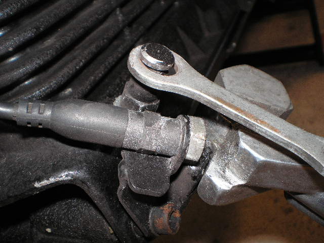

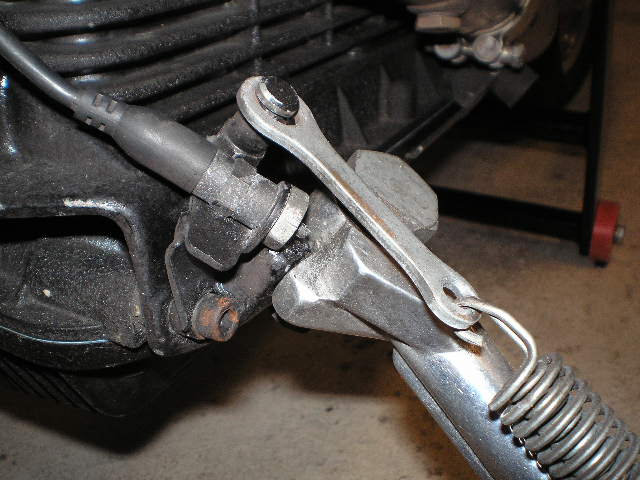

You're absolutely right. There is an adjustable bolt missing from the sidestand. After your last post, I found a diagram of the original setup in an online parts manual and there it was, a socket head type bolt with a locknut that would obviously make contact with the switch plunger when adjusted properly. I will find a suitable replacement. Thanks for the advice. Tomcat
Thanks for the reply. Can't picture in my head what this proper bolt looks like. Any chance you could post a pic of the proper configuration? Like I said, I just got this bike not long ago and I'm not very familiar with how some of these bits looked when they were new. As far as adjustment, the switch is all the way down now. No more threads left to bring it closer to the sidestand. That's what makes me wonder if this is even the right switch in the first place. Thanks for the help. Tomcat
Correct me if I'm wrong please, but isn't this switch supposed to be depressed by the kickstand when it is down? If I understand how this is supposed to work, when the switch is depressed, the bike can't be put into gear without killing the engine. I just got this bike afew weeks ago and I'm still getting familiar with everything. Will somebody post a pic of what this switch should look like please? I suspect that either the plunger that acuates this has been somehow shortened or the swicth was replaced at some point with the wrong part. The plunger doesn't come anywhere near making contact as you can see. Thanks. Tomcat
