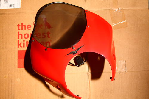

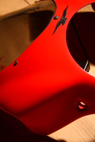

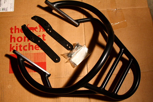

  22. Still available: MG rear rack in new condition, black, also with everything it should come with ... brackets and hardware - $199. Ballabio windscreen in Red in very good condition - $149. PM or email abetlej@gmail.com
