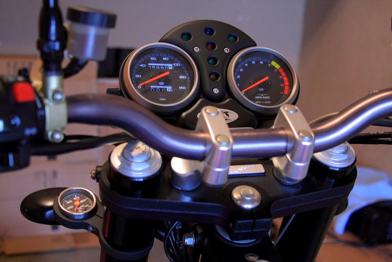

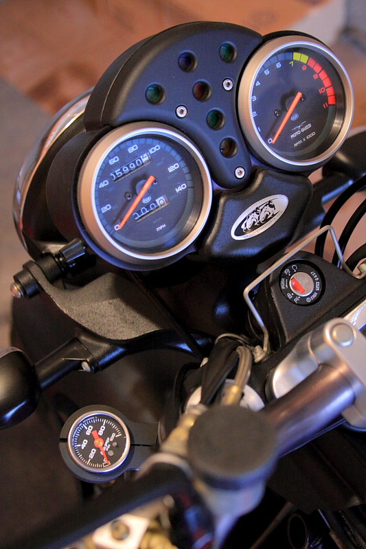

thanks. I scored one of these mounts on sale and had local machine shop change the diameter to 53mm. ($5) Painted black and mounted 1-1/2" gauge. looks good, but I have the Ballabio front headlight assembly that is stationary and so the gauge needs to extend out some to clear when turning. once I change the front to the sport type, then I will tuck it in. all in all $100 bucks.
I installed a pressure gauge in a different way than what was described on the forum already, so I thought I would share how this looks.

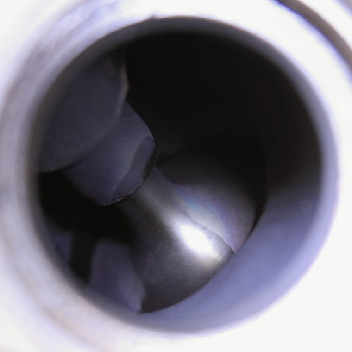

Attached is a picture looking inside one of the exhaust ports - it clearly shows oil leaking down the valve. I am sending the heads back out to the shop that did the work - so is there anything I should be cautious about when talking with them. Is this evidence enough for a free repair? What do you think is required to fix this problem? What is a cause of such leak? Thank you again. -

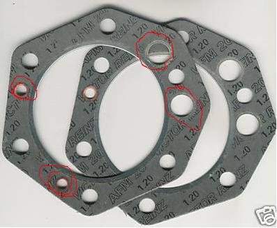

Thank you all for the input as I try to figure this out. Last night I had a chance to take off the heads again, and I have a some observations: 1. There was again oil in the cylinders - given 2. There is evidence of oil on the valves inside the ports - looking in from the side of the heads into the ports. Valves are wet starting at the guide, and the oil spot expands as it reaches the bottom of the valve - exhaust port (I will try to make a photo) 3. Upon inspection of the head gasket, I found oil around the openings of the push rods, as circled in the attachment. no oil around the main head studs, suggesting the o-rings are not the problem. Arek -
