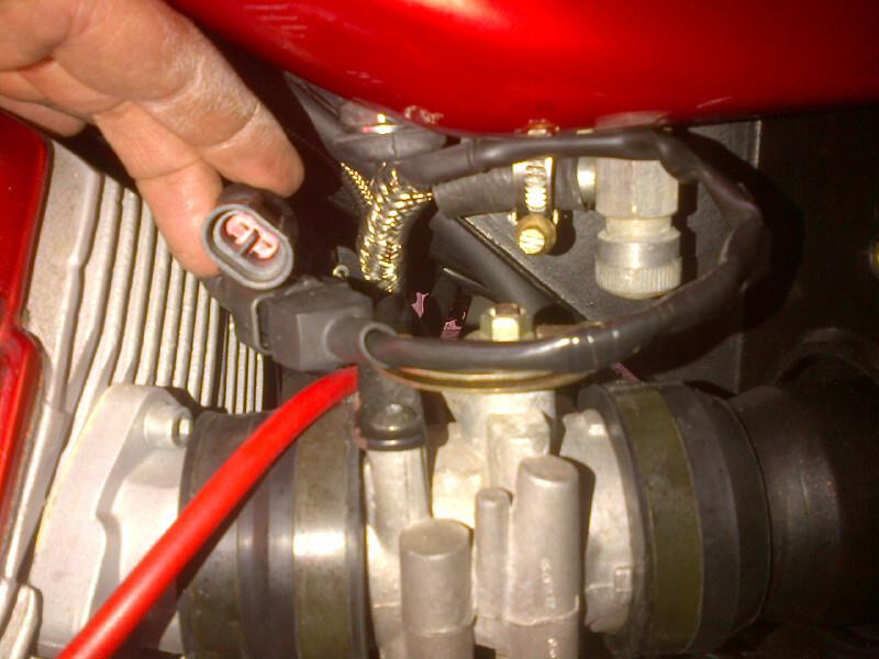

Thanks Roy -- I sincerely appreciate you sending over the schematic (going to sit down tonight and review) -- quick question -- did you see/note the photo I included on my first post above? Could that connector be for/complete the safety circuit? I'm not good on electrics...could not locate where that connector went -- it appeared to come off the main harness mounted to the spine of the frame. In the interim, I ordered all new relays from dpguzzi -- one of the relays had some corrosion (slight) on the outside of the plastic housing - figured I would replace all the relays...lastly, I had the kickstand down -- I'll try with it up? What did you think of the battery light staying on even after the key was out? Thanks again Roy -- sincerely appreciate the help and am looking forward to your response. Sean

Hello...been awhile since I've been on this forum (good to be back - had two V11 Lemans and missed having a Guzzi) and now picked up a V11 Sport Rossa Mandello... Couple of items about the bike; Hasn't been run in about 7 years When I purchased, supposedly a fuel injector was toast - otherwise, once the injector was replaced, should be "good to go" Well, I replaced the injector, installed a new battery, cleaned her up, and tried to fire her up today -- no go. Some observations; Battery Light came on and stayed on -- even when I took the key out of the ignition Did not hear the "gear sound" of the fuel injector/ecu when I turned on the ignition - knew I was dead in the water right away when I didn't hear that sound Lights came on, turn signals and horn worked and rear brake light One unknow cable was not installed/plugged into anything -- see photo -- did not/could not figure where it went and/or what is was for Only one wire coming off the gas tank -- plugged in the only wire (yellow male and female ends) other wire just remaining unplugged Just sat dormant with no response...any help and/or suggestions would be great. Thanks its good to be back...

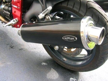

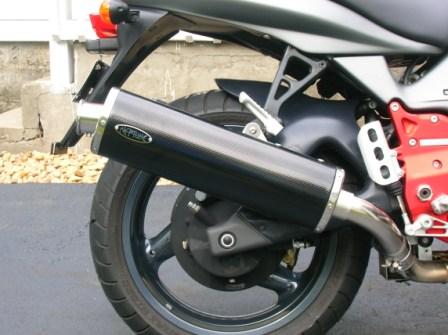

Hello Again, Thought I would put this post back out there..... I installed a set of Neptune Pipes on the Guzzi, which, as a comment are beautifully made + sound great, however, am in need of the passenger blocks/pucks (Neptune Pipes have threaded openings to receive) which are installed on a set of stock mufflers where a pasenger rests their feet without burning/melting their toes.....the Tenni came with the Carbon Fiber wrapped stock pipe, but without the footrests as they are normally installed on V11's. Anyone have a set they want to part with along with the bolts that allow attachment to the mufflers.....and/or comments/suggestions would be appreciated. Thanks. Piper1
Raz, No, pretty conventional....they are checkered stainless steel, oval shaped and pretty traditional in appearance..... I think I had mentioned different not so much in appearance but in not seeing many of the Neptunes on bikes....as a comment, they went on perfect and fit like a glove.
