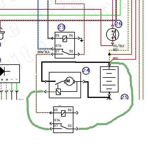

  1. And here is the adjusted wiring. You could add a fuse in line to the starter
  2. A while ago I make a drawing of the wiring adjustment, based on a drawing by Roy Kiwi. Here is the original

  7. For the no start isue: I had the same thing. The problem with many of the later models is that the relay powering the starter solenoid gets it's current al the way through the ignition switch, causing too much resistence. What you ll have to do is add a new extra relay. It's easy. Once I did the vollowing the problem was gone. Use the wire from point 87 of the starter relay (originaly feedling the starter) to feed 86 of e new relay, 85 of the new relay goes to ground. Now take a good wire from the battery to 30 of the new relay and and put the wire going to the starter (earlier cut from 87 of the old relay) to 87 of the new relay. Now the starter sollenoid is fed only going through 1 relay.

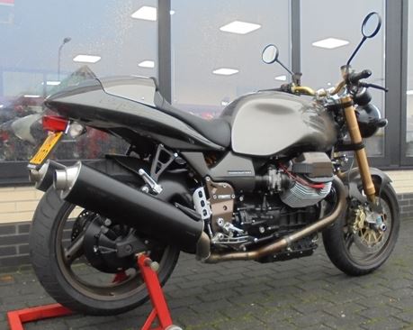

  8. I'm interested in this Cafe sport, which is for sale. It came from Italy. The shop owner won't let me take a test ride because of salt on the roads (winter time). I suspect it has had a crash as the front midguard has a crack, the windshield is missing and both the alternator cover and the odometer support are held by (not original) hex screws. Does anyone know the previous onwer? Note also the protectors on the cilinder heads. Cheers

  19. I think a lack of current at the sollenoid has a large part in this isssue. I have the same problem. The lack of current I guess is caused by the wiring going though the contact and back. In the inclosed picture the current comes from the battery through the contact, to pin 30 of the relay, through the relay, and then to the sollenoid. If I take the starter out and connect it to an old battery, it runs directly. I therefore always wandered if it would be possible to add an extra relay, which is feed by the original start relay (pin 87), and engages a current coming directly from the battery, going to the starter sollenoid (see second picture). Any gussestions about this? (Roy?)
