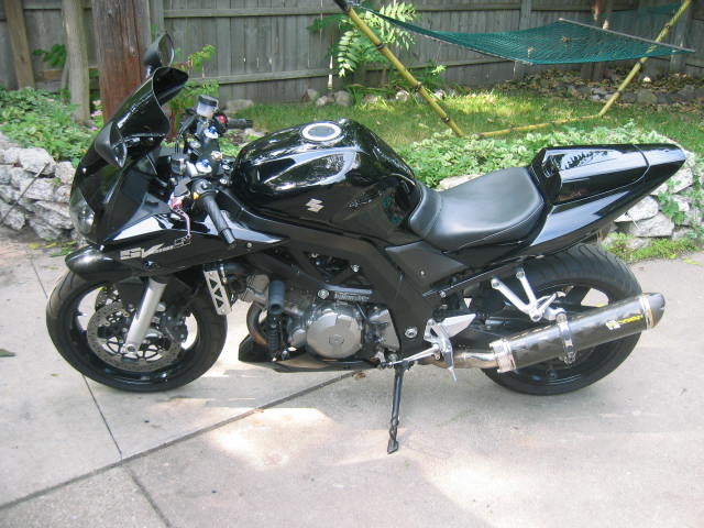

  3. I originally bought my 04 LeMans as a long distance tourer, and found I could ride it all day quite nicely, till it decided to quit, usually in states far away with no Guzzi dealer around, or way to get parts. U-Hauls get quite expensive...... Although I am keeping the LeMans because I love it, I now have addes a Suzuki SV1000S to the stable, and am VERY happy with it. I modified my Teckno mounts from the LeMans to fit the Suzuki, fabricated a quick release tailbag platform from the stock Suzuki grab rail, and added a Corbin seat, and I now have almost ferocious V-Twin power, a sporty yet extremely comfortable riding position, a bulletproof motor, a dealership/parts supplier in every town, (not that I should need it) good looks in a bike, and still ride something a bit different than you see everyday. Sadly they have decided to quit making this model, but I love it so much I'm tempted to buy another and just pack it away for when this ones worn out!! Oh, and theres usually a ton of em for sale on E-Bay at great prices too ! (avoid the 03 models)
