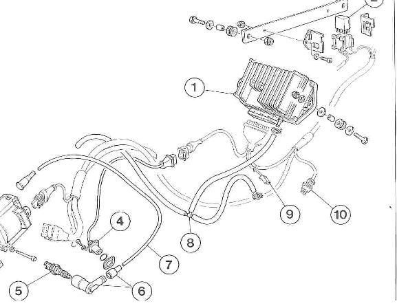

  8. I just found a guzzi 1100 carb manual. Looks like the vacuum should be T connected into the digiplex:
