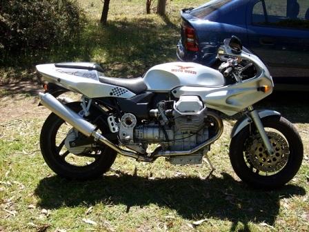

Hi everyone: I have my bike back on the road now after a gearbox internals swap, new clutch, full service and working on the bike's Keihin FCR jetting. I have attached a few photos below. I am still fiddling around with the jetting and would like to ask what sort of fuel consumption people are getting from their Sports? I checked and on the highway run (averaging around 100km/hr - 60mph) I was getting 4.65 litres / 100km and 5.47 litres / 100kms in more hilly / backroad riding. I think the bike is still running too lean in the slow fuel jet area and the fuel consumption looks a bit low to me, would be interested to know what other owners get. Thanks, Jason
