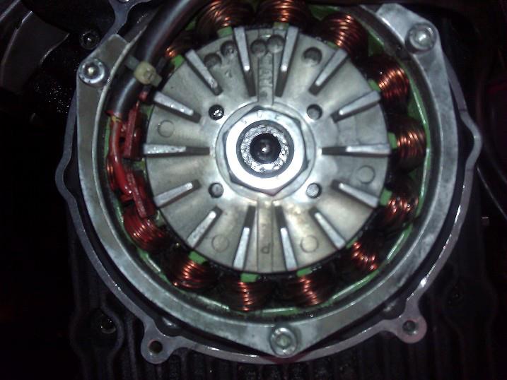

hahahha, I pulled it all off since I had to get behind the cover. Put it in the parts washer and it cleaned up nice. The lead wires looked really good.

Steve, if its not too late i'd advise you to leave the stock airbox on and do not go with K&N's. My bike came with K&N's and they were nothing but trouble. I tried resetting the tps, advancing the tps, relocating the air sensor and nothing made it work right. If you go K&N you will have problems with the stock ECU fuel map. I think Todd at Guzzitech quoted me $200 or 250 for a reflash but it didnt sound like an exact science so I put the airbox back on the bike ran like a top. Until last night when it died on the side of the road that is . I'm also in Dallas, well up near Denton if you want to talk guzzi. If you want to tinker with it run an extra ground wire for the rectifier and look into a maxi fuse for the charging system. Mine had troubles with the 35amp fuse melting until I put an extra ground wire in and cleaned up the rotor and stator. The stator gets oxidized really bad, the cover isnt quite air tight.
