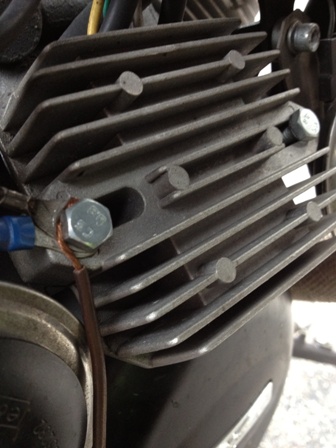

  7. Update: I've added a ground wire from the voltage regulator to the engine block as shown in the picture. My addition is the brown wire - have I done this correctly? (note the wiring is temporary). I've also checked all fuses and cleaned connections as well as removed and re-inserted all relays. Unfortunately still no change in the voltage numbers from what I posted above and the battery indicator is still glowing until about 2500 rpm.

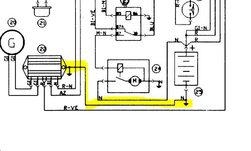

  11. Thanks for the info - I studied these diagrams and other posts... So I found the voltage regulator and according to my workshop manual there should be ground/earth wire connecting the voltage regulator to the battery (see attached pic). But, in real life, on my actual bike there is only a wire-harness plugged into the voltage reg with a bundle of wires. Is the green one running off the wire-harness plug the ground? Or should there be a separate wire somewhere else that should be grounding this thing?
