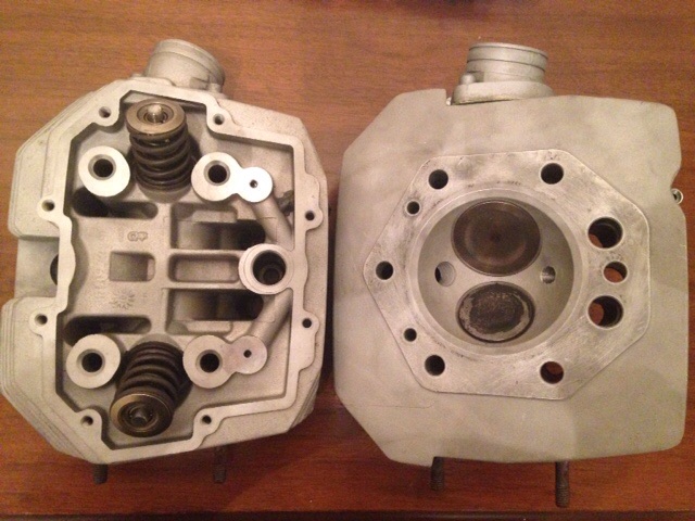

  17. here are some pics, let me know if there is some other angles or info you would like:

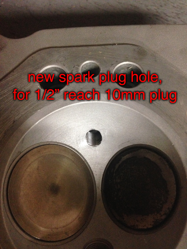

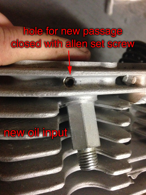

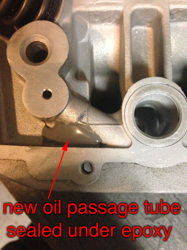

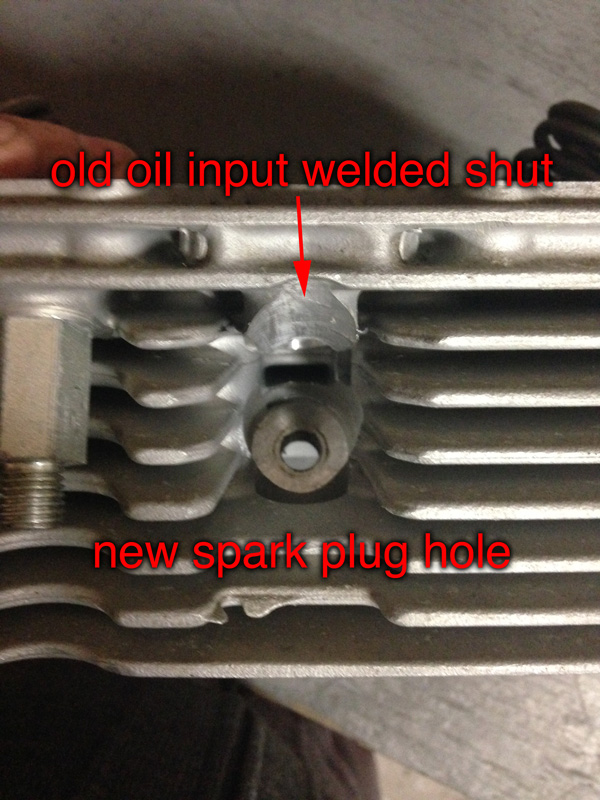

  19. motoguzznix - the Silent Hektik coils sounding more like the way to go, they supposedly produce a 120mj spark, the MagMar coils are quite a bit lower (don't have the exact number but I was told it was around 55 mj.) Should I consider the dyna coils, or is 3 ohms resistance too much? gelos - I will take some detailed pictures for you. The secondary spark plug hole goes through the oil input. The new oil input is moved over to the side.
