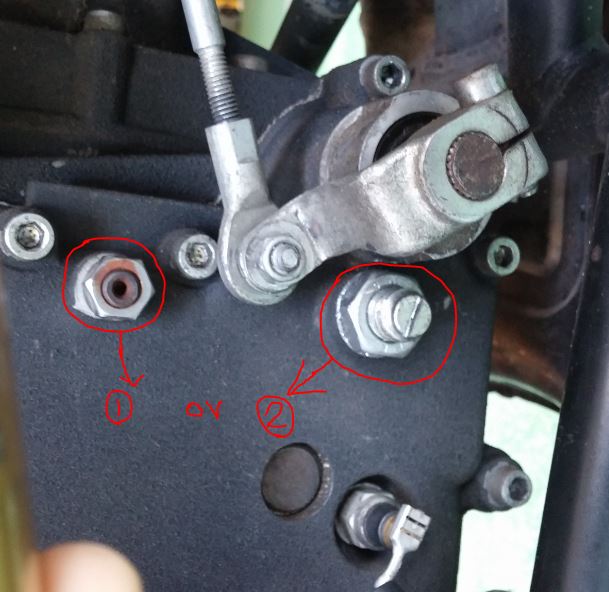

  5. Other shiftingsm is ok(1st.neutral.2nd.5th.6th) Are you suspecting clutch fluid or adjustment? Could u tell me more details which you are suspecting? I wanna do anything for repair. thanks in advance
  6. hi, everyone, I am v11 lemans owner in south korea. Just 1month ago, I bought this beautiful v11 lemans 2002y. Everything was good at that time. But now, I heard and felt something like metal gear griding sound or vibration when I shift up (2nd to 3rd) & (3rd to 4th), especially 2nd to 3rd. I have read many thread but I am still confused what am I supposed to do for adjustment or repair. This morning, I removed starter and check some bolts but I could not verify which one is eccentric adjust(=need to adjust) - no.1 or no.2(refer to attached file) when I turn no.2 bolt (counter clockwise or clockwise), the shift rod move upward and backward but still heard and felt grinding noise and vibration. -> I could not find any differences when I rode it. when I turn no.1 bolt, I could not find any differences. What should I do? it is necessary to open gearshift box? T.T thanks.
