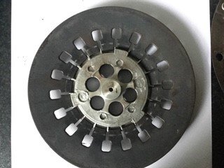

  1. Hello, Ik have a Scura in 2009 they replaced the cluth for a GU01080140, but now my clutch is slipping. I'm trying to find a new Clutch disk GU01084440, but is is not longer availible. I called TLM (the importer in the Netherlands) and they only tell me to replace it for a double plate clutch, and it will set me back 2000,- euro. Now i have heard it is possible te replace de friction pads on te clutch disk, but to do this, i need to know how thick was the clutch plate. Can anyone tell me this? kind regards, Jorrit

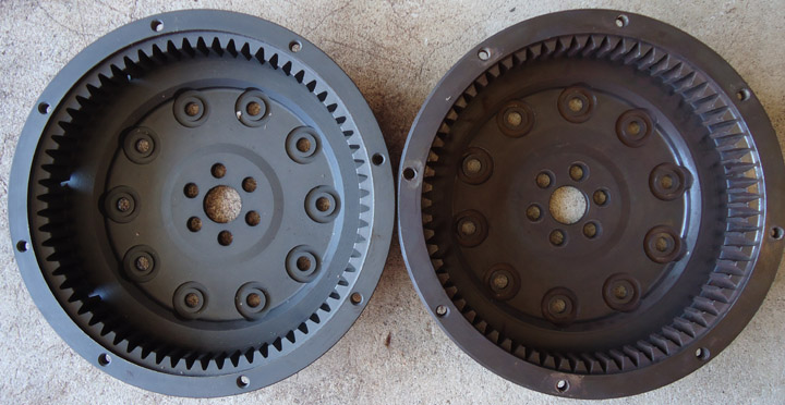

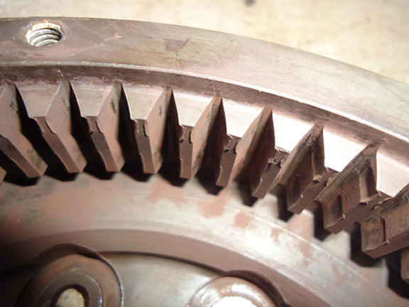

  4. My VII has 65,000 miles on it and since around 40,000 miles the clutch splines have shown signs of wear. I changed the transmission input gear at 45K, clutch plates at 50K and finally the flywheel today at 65K. The flywheel splines had the most wear, but was the most expensive piece. I finally obtained a new one at a good price. The clutch plates would not fully disengage. They would always be somewhat bound up because the splines had offset grooves. So the poor shifting is now like new again. See attached pictures below.
