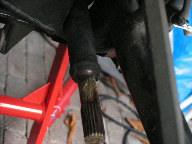

KiloSjon Posted February 4, 2007 Posted February 4, 2007 Removed the rear wheel today to re-spray the shaft drive thing. Noticed that the "eye" of the rear shock is broken. For the long term, this is not ok and I will see how to fix it (may be a good excuse to fit Ohlins?) but is it a problem for the short term? The other thing I noticed is that the dust cap on the shaft is also broken, I will fix this with a anti dust rubber shrink hose. No problem, I guess? Thx, KiloSjon
grossohc Posted February 4, 2007 Posted February 4, 2007 Hi I wouldnt ride the bike with the shock in that condition , this has happened a couple of times now, I think it happened on Martin Barret,s bike, do a search and see what comes up (Is it a sachs boge shock) Gary
Martin Barrett Posted February 4, 2007 Posted February 4, 2007 This is the thread on my failed shock. About half the bottom eye eventually broke off mine. I'm just glad it didn't happen whilst I was riding not just taking it off the shop stand. I would go with fix it now and not chance it.
