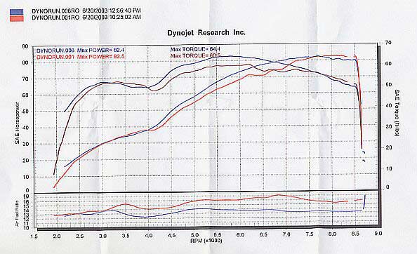

al_roethlisberger Posted June 21, 2003 Posted June 21, 2003 As reported briefly in another thread, I went and had my PCIII custom map made at Hare Racing, in Sunnyvale, CA today. First let me say that these were some very nice folks, and went out of their way to tinker with the map several times to try to address the ongoing idlling/coughing problem the bike has. That being said, after having the map made, peak HP was 82.4, and torque was 64.4. Unfortunately I do not have a comparison dyno for the bike as stock, versus the modifications currently installed. But I would have to guess that I've gained a handful of HP based on "seat of the pants" dyno, and past results I've seen from other stock bikes that had HP results in the mid/hi 70's. Peak torque seems about the same though. Although HP and torque weren't statospherically increased(and BTW I asked them to balance efficiency with power, leaning toward efficiency) it was "up" across the board as opposed to just peaks, and the curves for both were much smoother. While I still have a dip around 4-5k RPM, it is reduced, and the oddball dip in torque from 6.5-7.5k RPM was eliminated. Current setup: - Mike Rich "Stage II" Ported Heads - Dual Plugged Heads (but not yet "working", so moot at this point) - Increased Compression 1/4 point - Hardened/Coated Valves(same size, should have no effect on power) - K&N Pods - Stucci X-over - Leo Vince Exhaust ...and the PCIII of course Now if I can just figure out why it won't idle reliably worth a damn once warmed up. Sheesh... it'll idle fine, then... "COUGH"... stumble... maybe die... Then it'll idle for a while just fine. Then "COUGH". It used to do this out of the right TB, then the dealer more-or-less calmed it down(the coughing, it still died at redlights a lot), and now is coughing out of the left TB. I dunno. I'm going to recheck the TB balance this weekend, and hopefully that'll help. I'll probably run some "injector cleaner" through a tank too. Why not This idle thing is really bugging me though. It's the only real problem I've got with the bike If balancing the TBs doesn't get it, I guess my last hope is to go to the Raceco valves settings as Mike suggested. It's not a big deal to get done, but I just haven't taken the time. al
Guest Jeff Kelland Posted June 21, 2003 Posted June 21, 2003 Al, I am considering a stucchi xover for my le mans as I believed that it would remove the torque dip between 4 and 5k. It looks like it is still there on yours but it also looks like it occurs a couple of hundred rpm lower than on mine. I know you said it's improved but do you think that the dip moved down in rpm's as well? I am really curious about this. Good luck on your idle problem, so far this hasn't been an issue with mine since I put a couple of thousand miles on it, It did happen occasionally when it was new. Jeff
dlaing Posted June 21, 2003 Posted June 21, 2003 If you compare the dip to that of a stock bike you will see that on the stock bike it is MUCH more pronounced. So the Stucchi is doing its job. On this graph, stock is in red: http://www.scripps.edu/~dlaing/v11s/DL_V11...s-StockV11S.jpg
al_roethlisberger Posted June 21, 2003 Author Posted June 21, 2003 It's hard for me to tell how well the Stucci, etc... diminished the infamous 4-5k RPM torque "dip"... as I never took the opportunity to dyno the bike completely stock, although I wish I had. That being said, the "butt dyno" after installing the pods, x-over, and exhaust... even before the custom map... exhibited a pretty obvious improvement. But as a comparson, John's "suped up" Rosso with the additional benefits of a new cam, valve-springs, and balancing... still exhibits the same dip in the ~4-5k RPM range, although his output is increased across the board as well. Hot Rod Rosso Thread So I can only assume that barring some new discovery by some tuner, the 4-5k dip is somewhat endemic to this engine design and it's fueling system. It looks like it can be diminished and smoothed out, but will always be somewhat present. I don't know why though. al
RichMaund Posted June 21, 2003 Posted June 21, 2003 Geez Al I'm not trying to rain on you as you have spent a great deal of time & money on the bike. But your Dyno graphs look very similar to what bike achieved with just a set of pipes, a PCIII and general map for the equipment! You have me beat by 2 hp, about the same on torque. very close on the power delivery in the curves on the graph. But mine has no driveability issues anymore. 33 mpg city, 41 mpg hiway. I have to wonder if 90% of your money & time went into the last 10% of the performance gain?

dlaing Posted June 22, 2003 Posted June 22, 2003 I think when they dyno'd my engine it was equivalent to 3000 break in miles! Kind of unnerving when they run it past 8000 + RPMS wearing ear protection. If it did not drop a valve now, it probably never will. Keep in mind that all dynos are not alike, and that the fact that you guys both got less than I think we all would have predicted seems to indicate that you may have gotten more INDICATED power on some of the other dynos that people are reporting from. Callithrix got only one more HP than a stock bike in Las Vegas. So either they are not equally calibrated or the weather in Vegas is more conducive to high output numbers, (or both). If I compare my bike to the one in Vegas, I lost about 6 peak HP(and gained about 6HP at 4500rpm). It is possible that I lost that much or even more, but more likely only a loss of maybe 3 or 4HP, or so I will let myself believe
