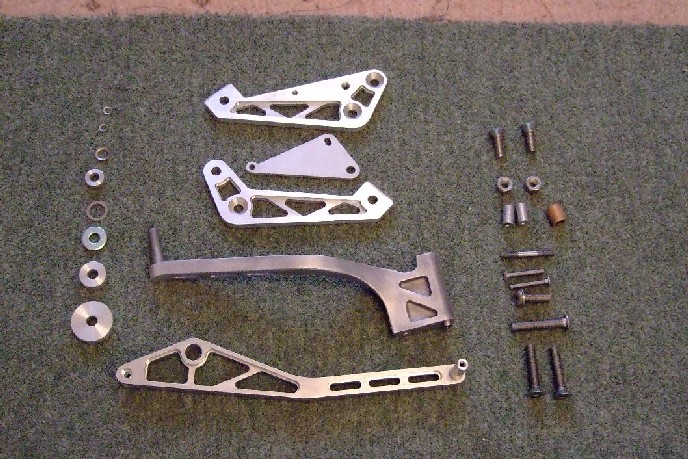

Ryland3210 Posted May 27, 2007 Author Posted May 27, 2007 John in Leeds said: They're here After a £42.73 customs and P/O charge they arrived well packed in 11 days from the US. Will do some polishing work before they go on, fit 'em, try 'em and report back after a decent mileage. Shame I couldn't have tried them on the ride down to Limoge but it was a good test for the Highland. Hi John, Glad they've arrived, though the customs charge seems very high. Customs duty to the U.K. has generally run between 2 and 8% in the many shipments I have previously made to the U.K. of various high-tech machine controls. Regarding P/O charges, that's a real surprise, as I prepaid the shipping at my end. You should only have had to pay customs duty. Thanks for posting the picture of the parts. It gives people considering these controls an idea of what's included. There's a lot more to it than just the 5 main components, because my goal was to avoid you having to purchase anything to install. There are a number of stainless steel and custom machined items included. best regards, John
