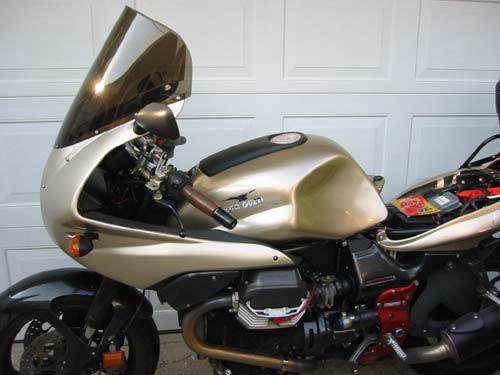

twhitaker Posted July 1, 2003 Posted July 1, 2003 Most of the buffeting is at the top of my head when I sit upright as possible. Otherwise smooth as can be. Frank did the handlebar riser change a couple years ago and that forced him to find a taller windshield. Like I said, the smoked screen is very dark. Get the clear one. The material is only about 2.5mm thick, it's preformed and bends easily, and you'll just need to transfer in the mounting holes. The kit comes with a drill bit ground specially for drilling plastic. It even has a spare little piece of plastic to practice on. Here is the pic. Gustaffsen phone number is 904-824-2119.
al_roethlisberger Posted July 1, 2003 Posted July 1, 2003 Question: Why did the manufacturer of the windscreen choose to cut the screen such that is has to be mounted on the outside of the fairing, unlike stock, which is mounted inside?? It seems like this is a little "less finished" and might catch debris, and maybe even be noisier, such as generate potential whistling. I'd also be concerned that it would scratch/abrade the painted finish of the fairing such that one couldn't reinstall the oritiginal windscreen later. Of course, I have seen a couple LeMans as delivered from the dealer with the windscreen incorrectly installed on the outside, but that was only in the first months when dealers weren't quite sure how these bikes went together Nice solution though. My OEM screen provides me more than enough protection, but I can see how many taller people, especially those with more upright bars might find this extra protection much more attractive for longer trips. al
twhitaker Posted July 1, 2003 Posted July 1, 2003 That's odd. I've seen over a dozen V11 LeMans and not one has had the screen put on the "right" way. I haven't noticed any dirt accumulating. Whistling noises? I thought that was my smile! Honestly though, it might have been cleaner, although more difficult to install, on the inside. Maybe next time.

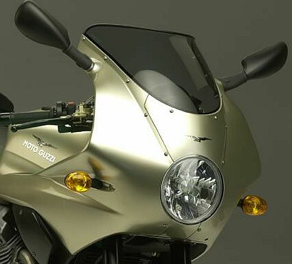

al_roethlisberger Posted July 1, 2003 Posted July 1, 2003 That's odd. I've seen over a dozen V11 LeMans and not one has had the screen put on the "right" way. I haven't noticed any dirt accumulating. Whistling noises? I thought that was my smile! Honestly though, it might have been cleaner, although more difficult to install, on the inside. Maybe next time. Wow, honestly not to be argumentative, but that is odd... maybe your regional dealer isn't aware of how the fairing should be assembled out of the crate? Honestly I've seen one with it mounted on the outside, and the fella told me the dealer put it on that way when they assembled it. He never realized it was "wrong" until he saw other bikes... then he noticed how the inside of the fairing is notched for the screen, outside edge is beveled, etc... hrmmm Given the soft MG paint, I can't imagine having it on the outside of the fairing would be very good for the finish long-term. While always a matter of personal taste, it really does look better mounted on the inside in my personal opinion Official MG LeMans photo:
twhitaker Posted July 2, 2003 Posted July 2, 2003 You're right. It DOES look better installed the right way. My bad.
