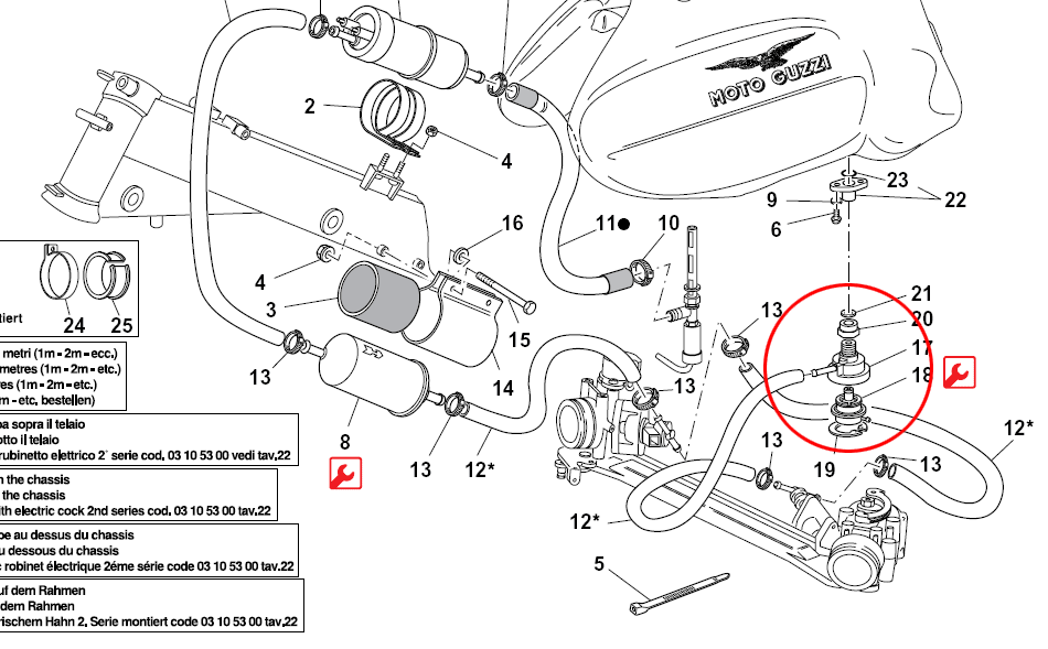

Admin Jaap Posted March 10, 2007 Share Posted March 10, 2007 This afternoon I fired up the Moneypit for the 1st time in 4 months. It only took one attempt! But... I suddenly noticed the fuel pressure regulator (that petcock thingy on the RH side) leaking like crazy. <_ probably a rubber ring that went south. btw it only leaks with running engine.> Is there an easy fix w/o having to order new parts? I really want to ride tomorrow! Link to comment Share on other sites More sharing options...

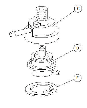

Dan M Posted March 10, 2007 Share Posted March 10, 2007 No offence taken Thanks for the input. Tomorrow morning I'll take it apart and let you know what's up. Should be quite straight forward. Jaap, If it is leaking from in between the two halves (C+D) in your illustration, there are o-rings in there that are easily replaced and likely of a common enough size to find at any auto supply. If the fuel is coming out of the lower nipple on "D" then the diaphragm has gone tits up and the only fix it to replace it. As Ratchet said, you might as well take apart and see. Good luck. Link to comment Share on other sites More sharing options...
Admin Jaap Posted March 10, 2007 Author Share Posted March 10, 2007 If it is leaking from in between the two halves (C+D) in your illustration, there are o-rings in there that are easily replaced and likely of a common enough size to find at any auto supply. This is the case. Only problem: on sunday mornings it's quite hard to find o-rings... Link to comment Share on other sites More sharing options...

Admin Jaap Posted March 11, 2007 Author Share Posted March 11, 2007 <_ stop making fun of monique. she allright.> Just a follow up: Took out the pressure regulator. Removing the circlip was easy but the regulator took some gentle persuasion to get loose. There are 2 O-rings, a small and a big one, both were o.k. There was some goo in there which apparently caused the leak, because when I cleaned and assembled it, the problem was solved. I love simple fixes... Link to comment Share on other sites More sharing options...
