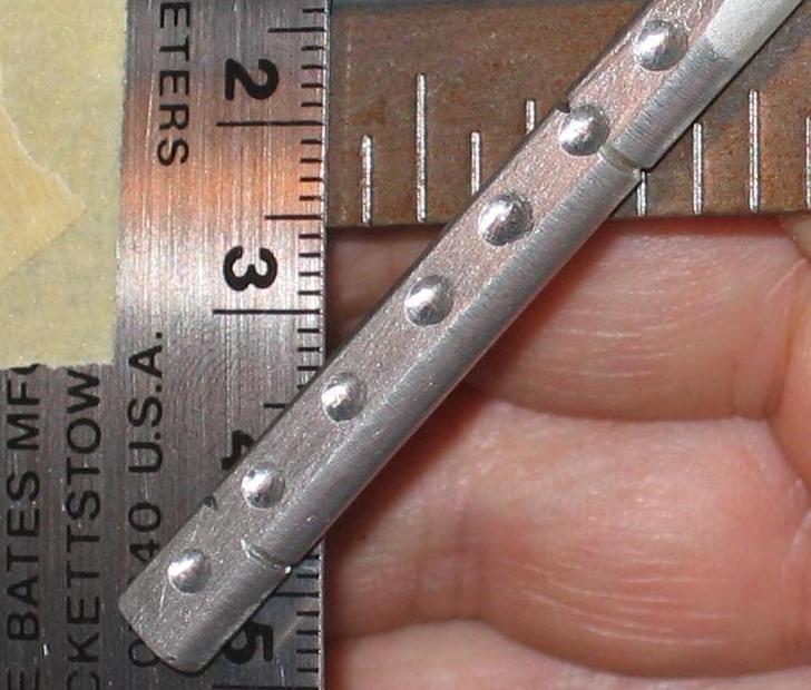

Alex-Corsa Posted March 16, 2007 Posted March 16, 2007 FWIW - Here's a shot of the business end of my dipstick screwed full home in the block (sump and spacer off, of course) with a straightedge held flat across the bottom of the block with a measuring gauge in cm, showing where the dipstick marks are relative to the block. The high mark is 2 cm below the block and the low mark is 4 cm. Adding to that usefull also would be to say the total length of the dipstick, length of stick I mean that is dippend to the oil sump (after screw and on) Have seen different lengths of sticks especially on aftermarket. So what's it on the one you got?
