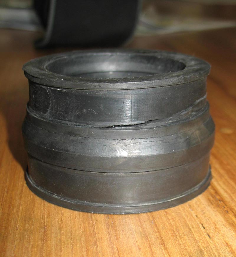

jihem Posted April 14, 2007 Author Posted April 14, 2007 But I think the idea that it may be an air leak, cracked boots or leaky exhaust gasket, are more likely the problem. you had it right: an air leak on the left hand BMC pod. You could barely see it but it had a lot of negative effect. It's fixed now. thanx all !
Admin Jaap Posted April 14, 2007 Posted April 14, 2007 As Dlaing said, I'm experiencing the same problems. Today I went to Assen to see my nephew race his R1. Under 4000 rpm the bike ran like crap! Jihem, where did you find the air leak? Between the throttle body and cilinder or between the throttle body and filter? BTW, fuel economy is definetly better after the dyno run. Normally, the fuel light came at about 210 km. Now it wasn't even burning at 230 km.! (At 230 kms I had to stop because my brother's Sir Drinkalot (Triumph SpeedTriple) needed fuel.)
Admin Jaap Posted April 15, 2007 Posted April 15, 2007 I found the culprit... The 4 cm. (!) crack was below the "slangklem" (Couldn't find the english word. ) so I didn't spot it right away.
g.forrest Posted April 15, 2007 Posted April 15, 2007 I found the culprit... The 4 cm. (!) crack was below the "slangklem" (Couldn't find the english word. ) so I didn't spot it right away. yes..''slangklem'' can't find the answer..but yes it's rooted.
jihem Posted April 15, 2007 Author Posted April 15, 2007 Jihem, where did you find the air leak? Between the throttle body and cilinder or between the throttle body and filter? it was between the throttle body and the filter. But it's fine now
Admin Jaap Posted April 15, 2007 Posted April 15, 2007 Thanks. I ordered a few of these rubber hoses at TLM (part # 01114300 ) to put on my garage shelf. Next weekend I'll ride without problems (knock on wood) to the Italo Day in Amsterdam.
luhbo Posted April 15, 2007 Posted April 15, 2007 Thanks. I ordered a few of these rubber hoses at TLM (part # 01114300 ) to put on my garage shelf. Next weekend I'll ride without problems (knock on wood) to the Italo Day in Amsterdam. Don't overtighten them. This is what kills them, not so much the ageing. If you see the rubber becoming deformed it's definitely to much. Hubert BTW, a comparison between your now optimised ecu and the Titanium race ecu would be most interesting. Any plans in this direction?
Martin Barrett Posted April 17, 2007 Posted April 17, 2007 I found the culprit... The 4 cm. (!) crack was below the "slangklem" (Couldn't find the english word. ) so I didn't spot it right away. Jaap, was that the one from the left or right. It was your left that popped off mid ride at the German V11 Treffen. I wonder how much the splitting was due to overtightening ( he might have small ladies hands but has a good grip )? My left one popped of a couple of years ago and at the end of last summer kept coming adrift and splitting. I'd wrapped with insulating tape whilst waiting for the replacement. I think my right is going the same way, but I have the spare ready. I think I'd probably ended up over tightening.
