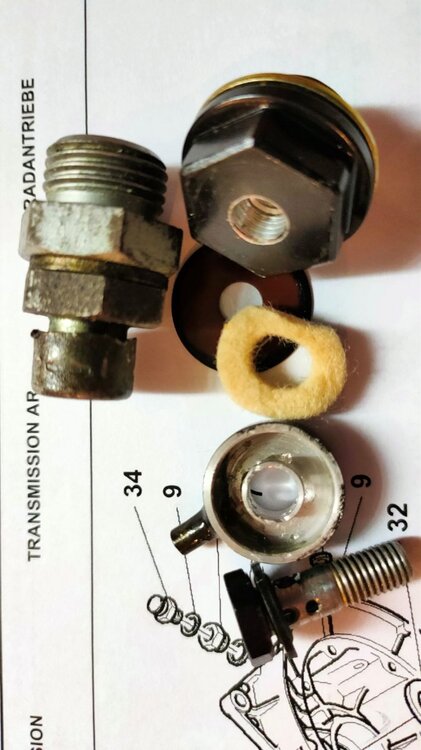

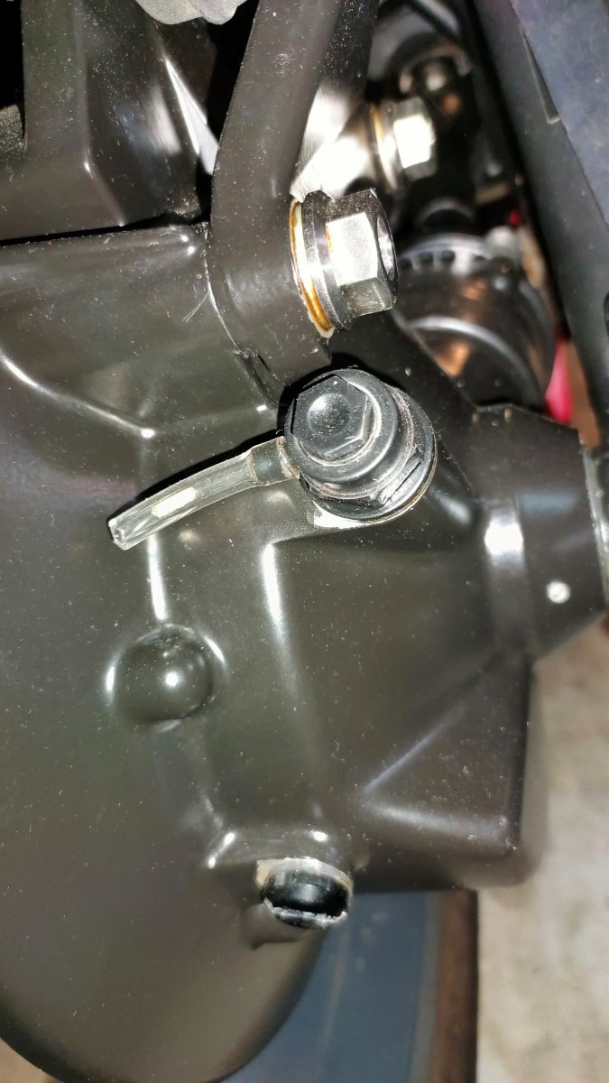

MartyNZ Posted September 4, 2022 Posted September 4, 2022 On 9/3/2022 at 11:39 PM, Walterg said: Thanks. Mine is indeed vented and I know it's open because it let's water in. I've never seen water in my bevel box, but I replaced the vent fitting anyway because: a. It could let water in. b. It was unnecesarily heavy lump of steel. c. because I could. . 1
MartyNZ Posted September 4, 2022 Posted September 4, 2022 Picture of the old steel fitting and the new mostly aluminium fitting. BTW, the original V11 vent is always open, so "burping" doesn't do anything. 1
