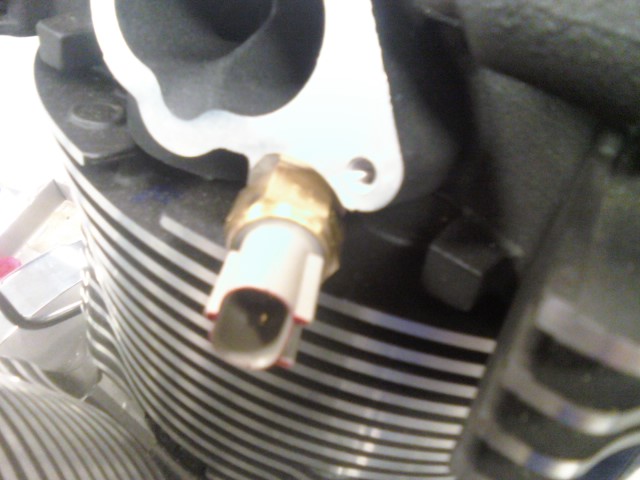

emry Posted February 9, 2009 Posted February 9, 2009 I just thought I would add these pics. Who ever is better able to determine a proper outcome, cheers. As a note I run a "homemade" brass sensor holder. Pic #1 Cylinder Head Temp on a Yamaha XV1900. Pic #2 Cylinder Head Temp sensor is on the left as compared to a standard Coolant Temp sensor from a water cooled model.
