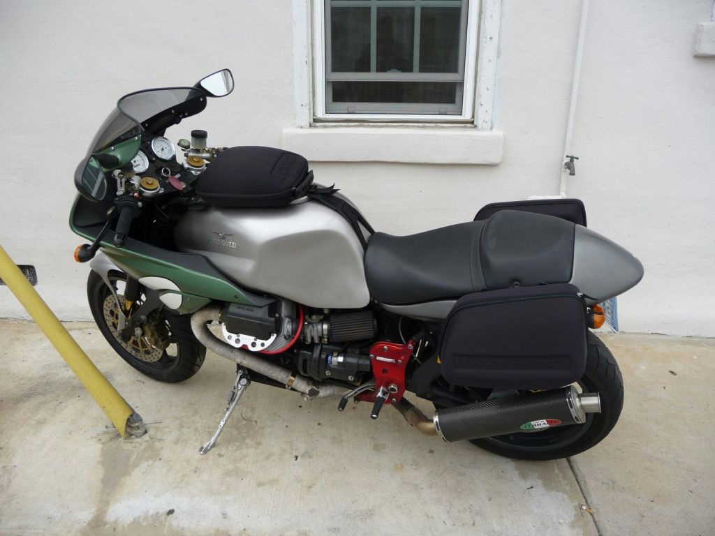

Motomonster Posted February 21, 2009 Posted February 21, 2009 Okay, I sent my PCIII map to Jaap, so you guys can check it out when it's posted. But yes, the left side is getting way more fuel than the right. I'd be curious to know why there's an imbalance. Anyway, here's a pic of my headers as well. The black is a high temp silicone spray that helps keep out the moisture and grime:
