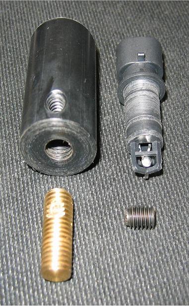

Dan M Posted April 3, 2009 Share Posted April 3, 2009 Since this is an EXPERIMENT, I'll be trying various combo's and different air gaps (and thermo-compound) until I have a better understanding of what the ranges of limitations and optimums are. With low or no air gap and thermo-compound in there, this is as direct a thermal connection as may be had. But since the thermal inertia of the thermistor is so infinitesimally tiny, as you've observed previously, running with an air gap may "smooth out" unwanted temp spike reads, while still providing very accurate overal reads without appreciable lag time in response to temp changes. I hope to gain more clarity on this later. I'm thinking you have the hot set up so to speak right now. The sensor is designed for air. Thermo paste is adding mass so it may hinder it. I guess that is what experimenting is about. What I really like about all of this is it is lending some credence to early musings from about 30 pages ago when the naysayers were dismissing it as nonsense. Of course they still will..... Link to comment Share on other sites More sharing options...

dlaing Posted April 4, 2009 Share Posted April 4, 2009 I'm thinking you have the hot set up so to speak right now. The sensor is designed for air. Thermo paste is adding mass so it may hinder it. I guess that is what experimenting is about. What I really like about all of this is it is lending some credence to early musings from about 30 pages ago when the naysayers were dismissing it as nonsense. Of course they still will..... (not that you are stupid!!!) I see some room for improvement, but I think I'll be ordering one of these sensors! I'd consider replacing the brass threaded piece with an aluminum one, and I might pursue something other than the Delrin, but I don't know what....glass? I am having trouble with the photo, is the GM sensor threaded?, if so, what is the thread size/pitch? Link to comment Share on other sites More sharing options...

Dan M Posted April 4, 2009 Share Posted April 4, 2009 (not that you are stupid!!!)I see some room for improvement, but I think I'll be ordering one of these sensors! I'd consider replacing the brass threaded piece with an aluminum one, and I might pursue something other than the Delrin, but I don't know what....glass? I am having trouble with the photo, is the GM sensor threaded?, if so, what is the thread size/pitch? The GM sensor is not threaded. It is designed to push through a grommet in a plastic air box or duct. I believe RH is securing it in his holder with a set screw. Link to comment Share on other sites More sharing options...
Guest ratchethack Posted April 4, 2009 Share Posted April 4, 2009 The set screw secures the threaded brass conductor stud. The GM sensor has no threads, as Dan noted. It was about .02" too large in diameter to fit the .5" bore I put in the holder, and has ribs on it that I sanded down until it was a "just right" secure, interference (push in) fit. Link to comment Share on other sites More sharing options...
gstallons Posted April 4, 2009 Share Posted April 4, 2009 The GM sensor is a 3/8" NPT thread I stand corrected. I was thinking of the coolant temp.sensor. The part in question is an air intake temp. sensor. Link to comment Share on other sites More sharing options...
