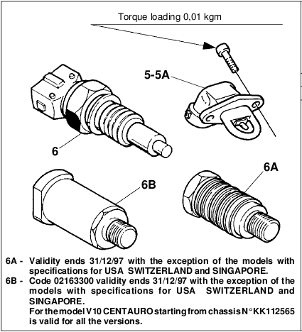

raz Posted April 30, 2009 Posted April 30, 2009 I shouldn't post in this thread but I stumbled over a relevant little piece of information while looking for something else. This is from my Sporti/Daytona RS/Centauro WHB. The text about part 6A vs 6B (brass vs plastic) indicates that the change to plastic was not for cost reduction but rather some kind of emission issue. Also, at one place they actually make a difference between the Sporti having an oil temp sensor while the V10 (with a sensor similar to your V11's) is called engine temp sensor. So they were not quite as confused as I thought a couple of hundred pages ago.
Guest ratchethack Posted April 30, 2009 Posted April 30, 2009 I shouldn't post in this thread but I stumbled over a relevant little piece of information while looking for something else. This is from my Sporti/Daytona RS/Centauro WHB. The text about part 6A vs 6B (brass vs plastic) indicates that the change to plastic was not for cost reduction but rather some kind of emission issue. Also, at one place they actually make a difference between the Sporti having an oil temp sensor while the V10 (with a sensor similar to your V11's) is called engine temp sensor. So they were not quite as confused as I thought a couple of hundred pages ago. Interesting, Raz. Makes perfect sense. From my testing of the brass holder alongside the OE plastic holder this Winter, I found that since the brass sensor body is 1.4 oz of almost solid brass, and the brass holder adds another 2 oz., the entire 3.4 oz lump takes far longer to come up to something close to temp equilibrium with the head -- particularly compared with the 1 g. low mass GM/NAPA Echlin sensor/Delrin holder. In cooler ambient temps, this time interval stretches out considerably. The entire time it takes to warm up the 3.4 oz of brass, the sensor is telling the ECU that the engine is still not warmed up, and the ECU is still sending fat pulsewidth signals to the FI. Running over-rich over a prolonged startup interval = Not good for startup emissions testing (or mileage). WRT the name change from "oil temp sensor" to "engine temp sensor", I reckon the significance here (or lack thereof) could very well have been due to a different supplier, a different translator, a different vintage grappa in the workshop, &/or in Tech Pubs -- or some combo of all of the above.
