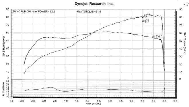

Guest teros1 Posted July 21, 2003 Posted July 21, 2003 Here is the dyno run of the bike with mods. I have no "before" run. Note that, as I suspected, it is running a bit rich....
Guest teros1 Posted July 21, 2003 Posted July 21, 2003 I say that it's running "rich," but note the following (from an RC-51 forum): "...The majority of tuning all comes down to the Air Fuel ratio. Optimum power is generally around 12.6:1 while the stoichiometric value for a gasoline burning engine is about 14.6:1 for a good compromise of performance & mileage...."

dlaing Posted July 22, 2003 Posted July 22, 2003 That looks like an excellent lamda curve considering you did not custom map it, yet. Looks like Guzzi did a good job with the aftermarket ECU.
RacerX Posted July 22, 2003 Posted July 22, 2003 Teros1, actually the stoichiometric value of 14.6~7:1 and/or the optimum power of 12.6:1 does not really apply well to Guzzis. Water-cooled, modern technology is needed for the upper ranges, and while mid 12 ratios work well for power, they'll pay hell on mpg's. Ask the folks here that have mapped in the mid-to-high 13 range about power, pinging, and mpgs. David, actually the posted graph does not show very good numbers for the a/f ratio target, and infact most who I've chatted with that are using the Ti-pipes have gone back to the stock ECU with a PCIII (non-custom/generic map) with decent results. I'd look forward to seeing the (custom PCIII mapped) numbers for this Ti/ECU combo. Back to lurk mode, Todd GuzziTech.com

dlaing Posted July 24, 2003 Posted July 24, 2003 RacerX said: David, actually the posted graph does not show very good numbers for the a/f ratio target, and infact most who I've chatted with that are using the Ti-pipes have gone back to the stock ECU with a PCIII (non-custom/generic map) with decent results. I'd look forward to seeing the (custom PCIII mapped) numbers for this Ti/ECU combo. I am sure it will be improved after a remap. Todd, Do you have any A:F ratio graphs of the un-remapped stock ECUs. I would have been certain that they would have been more off base than his graph shows. I know my bike made a huge change after the dyno tune. Of course my muffler was probably largely responsible for Lamda being sooooo off. Perhaps I gave the dyno dudes too much creative license. Attached is a before and after dyno tuning. Next time, I'll just give them Todd's recommendations. Thanks Todd for my overlays and all the help.
