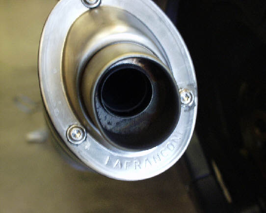

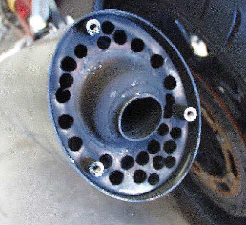

Just as a clarification, after drilling out the holes in the back plate, one does *not* cut out the rear support/weld for the inner muffler tube. The extended tube that normally peeks out of the rear "finishing plate/cover" is simply cut-off flush with it's weld as seen in the photos below. So this does not leave the inner tube/guts of the OEM Lafranconi mufflers unsupported as suggested above.
Trimming off this extension allows the gasses and sound to now escape around and out of the now more open hole in the "finishing plate/cover". So no modification whatsoever is required for for the "finishing plate/cover" for the new increased sound and gasses to escape. It looks totally stock from the rear, unless an experienced eye is looking ^_^
The photo below shows quite a "hodge-podge" of seemingly random holes, and I agree with Janus that this many holes are not really necessary. Probably no more than 9 or 10 holes drilled around the perimeter of the rear of the muffler are sufficient to add a little more bark and baritone to your exhaust without over-doing it.
Hopefully it's clear in the photos.

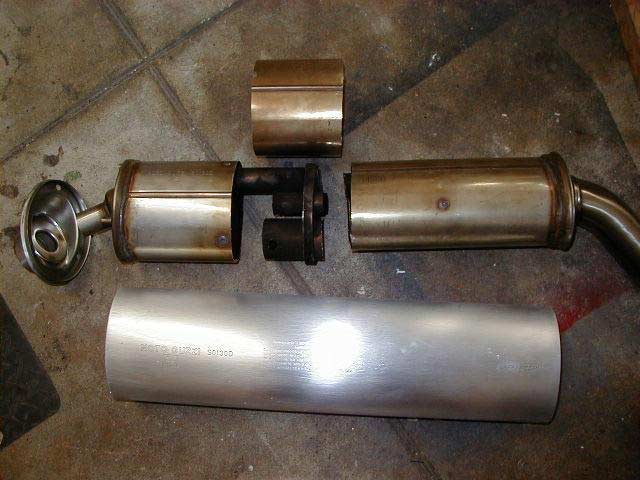

Stock muffler 101,
Here is a stock muffler sectioned from my 00 V11 Sport. It consist of three chambers in which different diameter tubes pass through. This is what creates the back pressure in the stock system. The lower large tube in the center section is the exhaust inlet. The exhaust comes in and runs toward the rear chamber, then is redirected back through the two small center tubes back to the front of the muffler. Once again after going through a baffle, the exhaust again flows back to the exhaust outlet. This is why the stock muffler gets so hot, the exhaust makes three passes through the muffler before it exits. The rear chamber is filled with some kind of metal packing so by drilling out the rear of the muffler it will create less back pressure along with more sound. When the packing burns away, one might have a very loud muffler. :o
Mike
Rear section with a perferated wall filled with steel packing. The tube on the right side is the outlet pipe.
Mike
Thanks Mike,
It's great to see one of these autopsied finally :thumbsup:
It looks about how I expected though, based on what external observations could be made, along with the results from drilling, etc.
Although I guess one could now "core" one knowing this, it wouldn't be a minor task.
al
