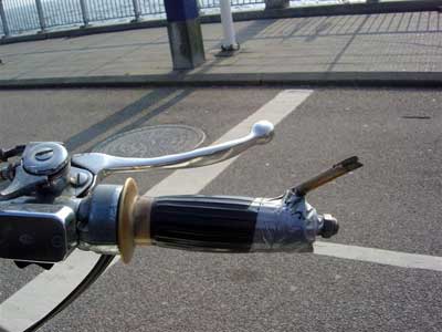

Now this is what I call bodging. Done by member of Norwegian Guzzi Club someplace in Poland on an epic journey through seven countries on route to Mandello....
duct tape and twig. cost: nada.....
That one is clearly scarier than mine. At least with the "o" ring on a string, all I need to do is pull the string with two fingers to dislodge the "o" ring to free the throttle return. And it takes little pull to do it.
Guest ratchethack
Ah, but the way the stick bodge works, all the rider needs do is move his hand inward, or as an alternative, let go. ;)
