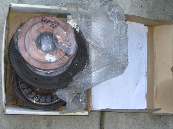

RichPugh Posted June 25, 2007 Author Posted June 25, 2007 I'd see if I could find out wot happened to the original clutch and flywheel, and if possible, get ahold of it and keep it as a spare -- just for "insurance" purposes, y'unnerstand. . . It ain't doin' anybody any good not bolted to a Guzzi crank, and with only 1700 miles on it, it's more'n likely in new condition. . . BAA, TJM & YMMV I have the clutch...
Guest ratchethack Posted June 25, 2007 Posted June 25, 2007 Outstanding, Rich. Now this is just me, but at the first sign of anything funny goin' on with the Ram clutch (anything at all), I'd have that original flywheel and clutch back in there PDQ. BAA, TJM & YMMV
RichPugh Posted June 26, 2007 Author Posted June 26, 2007 Outstanding, Rich. Now this is just me, but at the first sign of anything funny goin' on with the Ram clutch (anything at all), I'd have that original flywheel and clutch back in there PDQ. BAA, TJM & YMMV Well this is kinda why I started this thread... I was worried about the noisy gearbox. With the clutch lever pulled in, its lovely only hearing the tappy tappets but let that lever out and CHICKACHICKACHICKA.... noisy... It sounds acceptable but I have absolutelt nothing to compare to. I'd like to hear several other Guzzi gearboxes.
