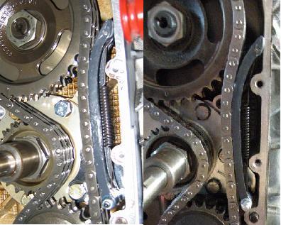

raz Posted January 8, 2010 Author Posted January 8, 2010 OK I'm there now. As expected, the tensioner has visible tracks from chain wear. It's not very deep though, so the tensioner should last as long as the chain. Remember to order the seal in the timing cover as well as the o-ring inside the alternator shaft bushing. I didn't replace them the first time, and had no problems. But it would be damn irritating if there was a leak afterwards. Same goes for the timing cover gasket of course. I've never tried to re-use that one. As you may know, as soon as you need more than just a couple of gaskets, a complete gasket set may be cheaper and then you have all you need and some for the shelf. Oh, and beware of a couple of dl of oil in there even if you dried the sump. My oil pump shaft has some amount of play. I can't remember if I replaced those bearings, need to check that. Now hold your thumbs, the next post (in the other thread) will be the results of my camshaft inspection

Guest ratchethack Posted February 1, 2010 Posted February 1, 2010 Well done, Slavomir. Just for grins, I looked at the photo I took when I installed mine for a little comparo: Mine's on the left, yours on the right. There's a small difference in amount of chain stretch between the two, judging by the curves of the tensioners. Check the relative distance between opposite sides of the chain at the crank sprocket. Just an observation. NOTE: In your photo in your post above, I see your stator sitting on the floor without the rotor in it. Now I KNOW that at least one on this board will say it doesn't matter (per post soon to follow, I expect ). I have no reason to doubt this. HOWEVER, my Guzzi service manual states: "To avoid demagnetization, insert the rotor into the previously removed stator once again." Having likewise no reason to doubt the manual, I followed it, and there was no loss of charging power.
