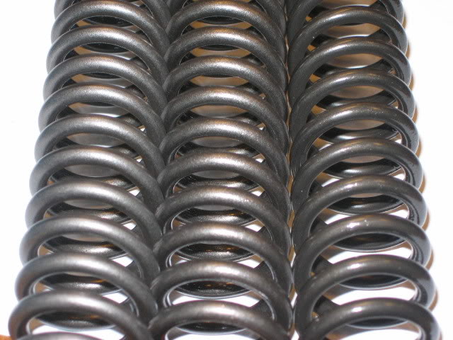

I am considering polishing the outside of the spring with some 600 then 1500 grit paper. Any thoughts?

The point being this. I can't see using anything beyond about 200 grit on steel springs (maybe 280 grit max!?), or you'll be at it for hours! No need for a mirror shine here, my friend! If 200 or 280 doesn't stop it from squawkin', I reckon nothin' will. . . :huh2:

I polished the springs with 400 grit and deburred the flats and corners. Perhaps the surface change is visible in the photo: left to right: polished TD, unpolished TD, original Marzocchi.
The squeak yet remains seemingly on the rebound side. I must now suspect I may have bent the damping rod to the cartridge during the set screw debacle. sad.gif
Looks mighty slick, Docc -- just my HO, but I don't see anything that would've likely contributed to squeak in the first place? :huh2:
YIKES! Well, 2 thoughts: It'd be easy enough to check by rolling the cartridge rod assembly on a flat surface. Part II, any decent machine shop should be able to straighten it out if it's bent. :thumbsup:

And, really, the 'squeak' is much better than in the beginning. I may try to polish the 'rebound' spring a bit more and see if I can 'tune' the noise away. :luigi:
