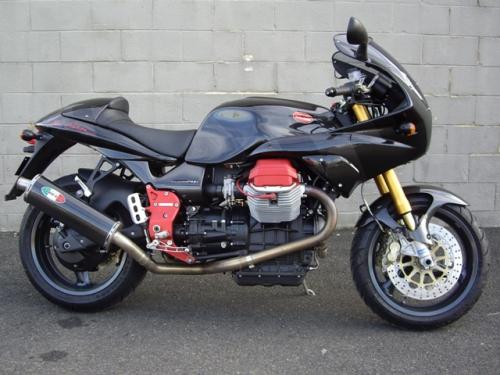

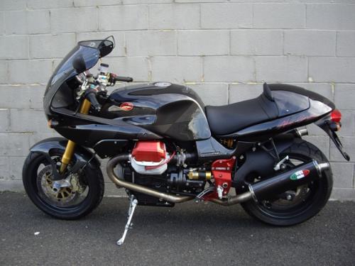

orangeokie Posted July 5, 2007 Posted July 5, 2007 . . . My one negative about the Staintunes, is that it makes the factory headers look like shite, obviously a lesser grade of stainless steel. Ciao, Steve Get out your check book . . . there's a fix for every "negative.! Clicky dis picky
GuzzBun Posted July 9, 2007 Posted July 9, 2007 Haven't tried Staintunes, but have had oval Mistral Carbon (which sounded good, and breathed well), and now have the factory Titaniums with Race chip - this is the way for me!!! Fuel economy improved markedly - now don't get the orange light until well into the 140s, sometimes 150s (OEMs lit the lamp at around 125!) - and the performance is markedly better too - crisp response, growls like an Azawakh on guard, and looks good compared with the carbon - lifts the rear end visually from the original overriding darkness - yes, I know Scura means Shade, but sometimes the contrast helps! Downside? Well, as other respondees have said, Titanium dents easily - don't carry pillions! The fixing is 'loose' i.e. the cans wobble slightly when cold, but they tighten up nicely when well-warmed (don't we all!?). They show up the stock downpipes, but that's easily overcome by cleaning the downpipes with a well-used Scotchbrite and Solvol-Autosol - fact is that stainless yellows when heated but Ti doesn't. Upside? They look fantastic, and sound fan-twattin-tastic! Go on get some - you know it makes sense!
