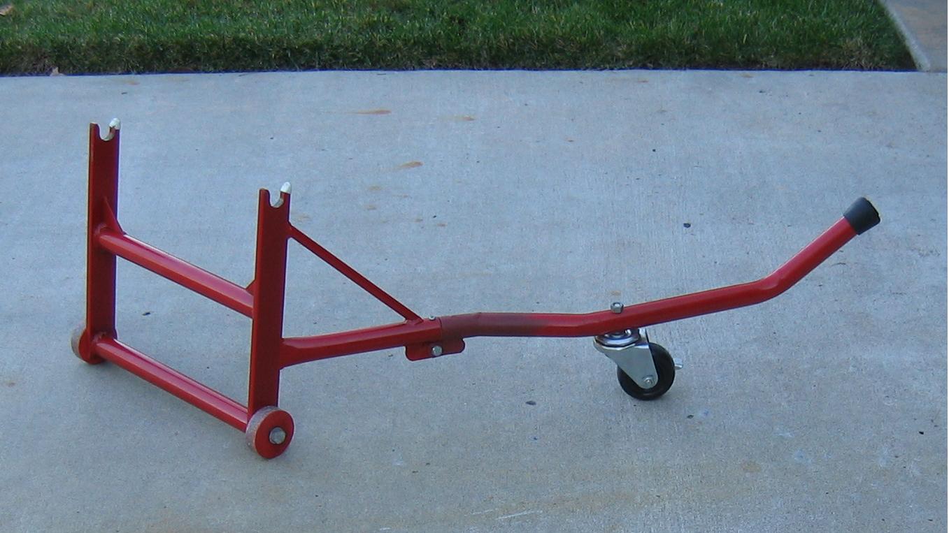

Guest ratchethack Posted July 12, 2007 Posted July 12, 2007 Dave, at first, I found that if you set the pedestal just in front of the sump, with a yardstick or similar stick resting on the lower flange of the pedestal, running forward past the front tire contact patch, you can stand in front of the bike and lift the front wheel by the fork lower ends and slide stick with one foot, pushing the pedestal back until it's just under the front of the sump, and set it down. Takes some agility. After thinking about this awhile, I came up with the following (see thumbnail below), which simplifies this a great deal by eliminating the stick, while giving the stand an added dimension of versatility that I don't know how I'd have done without over the years. Now I just lift the fork the same way and pull the bike forward over the pedestal and set 'er down. I found that being able to wheel the bike all around in and out of my shop with either front, back, or both wheels off is a great advantage. As far as stability goes, I found it stable enough to do anything I've ever needed to do, including getting the trans out and back in, with a "safety" support from above -- just for insurance against the unthinkable . Hope this helps.

docc Posted July 14, 2007 Posted July 14, 2007 Ratch, Looks like your stand has a couple mods. What are those 'tips' over the pork-chop gougers? Have you rebent the curve in the lever then repainted?
Guest ratchethack Posted July 14, 2007 Posted July 14, 2007 Good eye, Docc. I had a couple of plastic "protector tips" in my workshop left over from -- who knows wot -- that fit right on. I find they keep me from scratching & gouging the pork chops whilst engaging the stand. I also put a bend in the handle to allow the stand to clear the LHS muffler so I can use it either in the forward or rear position, which gives it a little more versatility and works well the way my Guzzi garage/workshop is set up. Oh yeah -- I also put a sheet-metal screw into the inner sleeve at the "take down" point to keep the sleeve from walking away from where it belongs every time I lift the bike.
