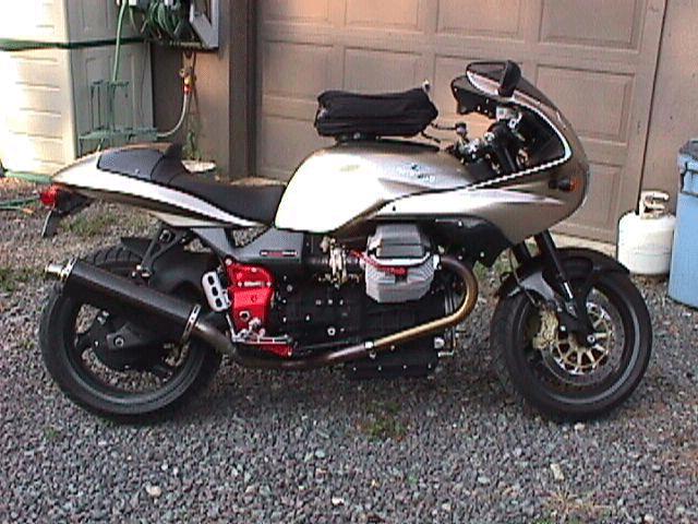

canada goose Posted August 12, 2007 Posted August 12, 2007 This is what I've been using for the last year and I'm very pleased with it. LuggageLocker The bike in the attached photo is not mine. Mine has the newer style tank without the raised "chinpad" or whatever the hell it's called. Because the filler ring of a V11 is slightly more recessed then other bikes, I had to slightly shim the mounting ring, so the bag wouldn't rub the tank, yet still allow the filler cap to swing open. It all works fine. The LeMans in the photo has the earlier style tank with the "chinpad". I'm guessing the mounting ring would have to be shimmed even more on these bikes. The optional Lexel material of the bag has a very nice feel. The bag is locked to the bike or you can unlock it and carry it away in about 10 seconds. If I was starting again, I would seriously consider SW-Motech. They "borrowed" the Luggage Locker design and improved upon it. They don't list a V11 application, but I'm sure it could be sorted out. Ken

Gregg Posted August 14, 2007 Posted August 14, 2007 If I was starting again, I would seriously consider SW-Motech. They "borrowed" the Luggage Locker design and improved upon it. They don't list a V11 application, but I'm sure it could be sorted out. Ken I have a SWMotech bag on my V11, it is great - easy to take on and off at fuel stops. I have mounted a 1/4" sheet of rubber to the leading edge to stop it rubbing on the top of tank pad. They do make a tank ring for the V11 and it is easy to fit. The e-mail address is noRRus.net [info@noRRus.net] and the guy who helped me is Markus Normann ( he does e-mail in English) very helpful. I bought the "Engage Sport" bag which you hopefully should be able to see in the attached photo (I hope) Gregg
