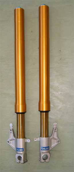

al_roethlisberger Posted September 24, 2003 Posted September 24, 2003 Well surprise.... surprise..... Paolo sent out the forks Monday evening, and they were sitting in Venice, Italy Tuesday morning when I checked FedEx online. But at 10am this morning, my doorbell rings and there is the FedEx guy handing me the forks in San Jose, CA I have never ever received any package that quickly, much less from *Italy*.... odd, but I'm not complaining The last think I ordered from Italy took 3 months to receive So, they're off to Lindeman Engineering today for new correct springs and a general "going over". I should in theory be able to start finding the correct axle, bushings, etc... in a week when LE is done. al
al_roethlisberger Posted September 24, 2003 Posted September 24, 2003 Used aluminum stock, bent and tapped for mounting. I put heli-coils in to make sure they are tight. Heya John, Thanks again for the photos of your bracket. Now that I've got my forks in-hand, I'm going to have to see if my stock front fender will indeed fit though, as the tab on my forks are a bit different than yours. Going from the photo, yours has a "block" that is relatively close to the fork end-cap where a fender would attach, while the forks I received have a tab in about the same location, but has a single hole and is a bit higher/longer. So I'll have to see if my stock fender clears this tab enough to make an adapter like you have done. ....crossing my fingers I'm assuming that the Ohlins you have on your bike were not Guzzi specific or OEM?? The ones in the photo below are what Paul, Jaap, and I have got. BTW, Paul/Jaap... also for clarification, did we ever *confirm* that these are the same forks as come on the 2003 Rosso Corsa/Cafe Sport? Just checking as I'm asking TLM about OEM parts(axle, bearing, spacers) , and want to make sure they will fit. al

al_roethlisberger Posted September 25, 2003 Posted September 25, 2003 Al, after all the measurments i've done , you still go for stock? I just ordered a 999 frontaxle, see if the 24 hour service from ducati works. :-) You only need one spacer custom made, that's the one between the bearings. The one on the outside, you allready have on you bike. Yesterday, I finaly got my PVM wheel and RSV mudgard. ...check your PMs Paul But no, I'm just checking all my options = $$ I dropped a note to TLM for the parts for the Rosso just to check if they're available and how much it would cost But, I suspect I will do exactly what you have done, and have an email to Victor at FBF for pricing on the 999 axle, nut, and washer. And my local suspension shop said they can make spacers with no problem, and cheap ~$20 Thanks for the clarification, and I appreciate the info in the PMs, but I wonder if I could get you to summarize it in a reply to this post so that Jaap and everyone could benefit? I'm afraid that all the bits & pieces in PMs and several posts make it hard to assemble. So here's what I understand that one needs, and please correct me if I am wrong: 1) Ducati 999 front spindle/axle: ducati part number 819.1.043.1A 2) Ducati 999 spindle nut: 748.1.014.1A 3) Ducati 999 washer: 8000.70119 Question: What are the dimensions of the Ducati 999 axle/spindle, esp the diameter? 4) One 104mm long spacer for the space between the bearings in the wheel Question: Related to the question above on the diameter of the Ducati axle, what is the inside diameter of this spacer required to be? 5) New bearings? This is one question I am particularly unclear on, although once I get my parts I'm sure it will all become quite clear. But never-the-less, with the Ducati axle, will I need *one or two* new bearings? And if so, what will be the dimensions? The bearing you cited in your PM had W=7mm, ID = 40mm, OD = 52mm I don't think the Ducati axle is 40mm, so this is where I am confused. Thanks for all the help Paul! al
Paul Minnaert Posted September 25, 2003 Posted September 25, 2003 1) Ducati 999 front spindle/axle: ducati part number 819.1.043.1A 2) Ducati 999 spindle nut: 748.1.014.1A 3) Ducati 999 washer: 8000.70119 Ducati 999 axle/spindle,is 25mm outside diameter. 4) One 104mm long spacer for the space between the bearings in the wheel Inside 25mm /outside +/-30mm 5) New bearings? This is one question I am particularly unclear on, although once I get my parts I'm sure it will all become quite clear. But never-the-less, with the Ducati axle, will I need *one or two* new bearings? You need one new, but only if you manage to get the rest of without toutching that one, so better buy two: 52x25x15mm == 6205 - 2rsi
