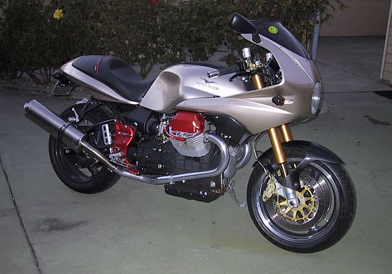

al_roethlisberger Posted November 23, 2003 Posted November 23, 2003 OK, well as mentioned in the dual-plug thread, I took the bike out for a short "shake-down" spin tonight after finishing a few projects, one of which was getting the front end all back together after installing the new axle, bearings, fender, and most importantly new Ohlins forks Now first, just let me say that I personally liked the look of the black stock Marz forks better on the bike, but based on my very cursory spin around the block... I think I can grow to look past their gleaming gold tone Well, it's too early to know anything in depth in regard to correct damping, spring-rate, etc... but I can say unequivocably that these forks are much more compliant than the Marzocchis. One of the most noticeable differences was when transitioning the sharp curb one finds when riding into a driveway or parking lot. With the Marzocchis, that bump was always quite sharp and jarring. With the Ohlins, it's soaked right up Now, it may be true that the Marz weren't optimally setup, as I didn't spend a lot of time on them in that regard since I knew I was going to replace them. So it is perhaps true that they were overly harsh and/or could have been better than what I experienced if tuned. But from a quick 15 minute ride, the Ohlins.... also so far completely "unadjusted" .... feels worlds better ....and of course, as others have pointed out, now with the front end feeling so good, the rear is highlighted as feeling even more especially like keeeeeeeeeeeeeerrrrap I know what's next on the shopping list, but then again, it already was al

al_roethlisberger Posted November 23, 2003 Posted November 23, 2003 ....partially all back together right after the "shake down" run Technically, still have a few issues like cleaning up the relocated fuel-pump, new PCIII map, etc... but most of the "user serviceable" things on my list before the engine case swap are done. Cosmetically, I still have to strip the rear wheel(while checking the splines and cush-drive for lubrication), and the current experimental powder-coated orange/red valve-covers are probably temporary until I get the new candy/metallic red coated ones back in a couple weeks. ...but it's coming together

Admin Jaap Posted November 25, 2003 Posted November 25, 2003 Looks stunning Al. And I'm glad you like the new fork! As an aside: If it turns out like I planned, I'll get my hands on a pair of Café Sport Öhlins forks in february. Second hand but hardly used. When I actually have them in my garage I'll let you guys know. Some other parts too...
